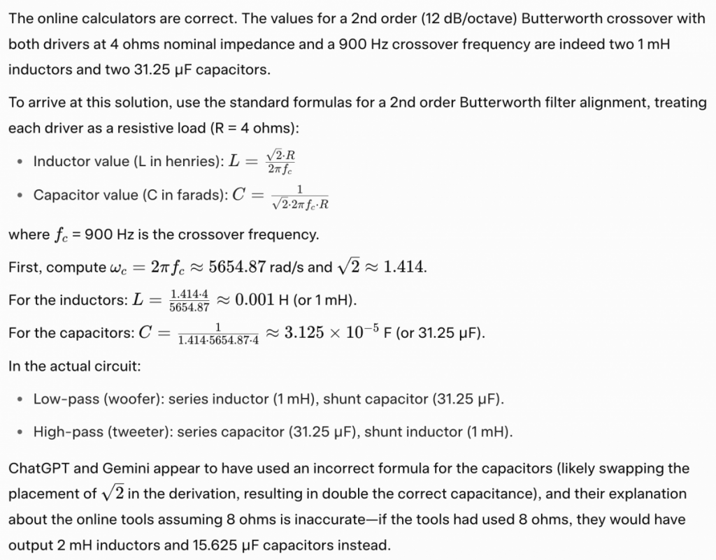

Grok is currently performing better than ChatGPT and Gemini in electrical engineering tasks (and on most things), and on Expert mode, it confirmed the 31.25 µf capacitor value. Here's the reply as an image to preserve the formatting:
Thanks for the confirmation. I just wanted to order some parts. My thought is to build a simple xover, put it in place during testing to protect the mid/tweeters and give a sense of what the speakers should sound like. Once I have everything together, I will take a stab at designing a proper xover.
