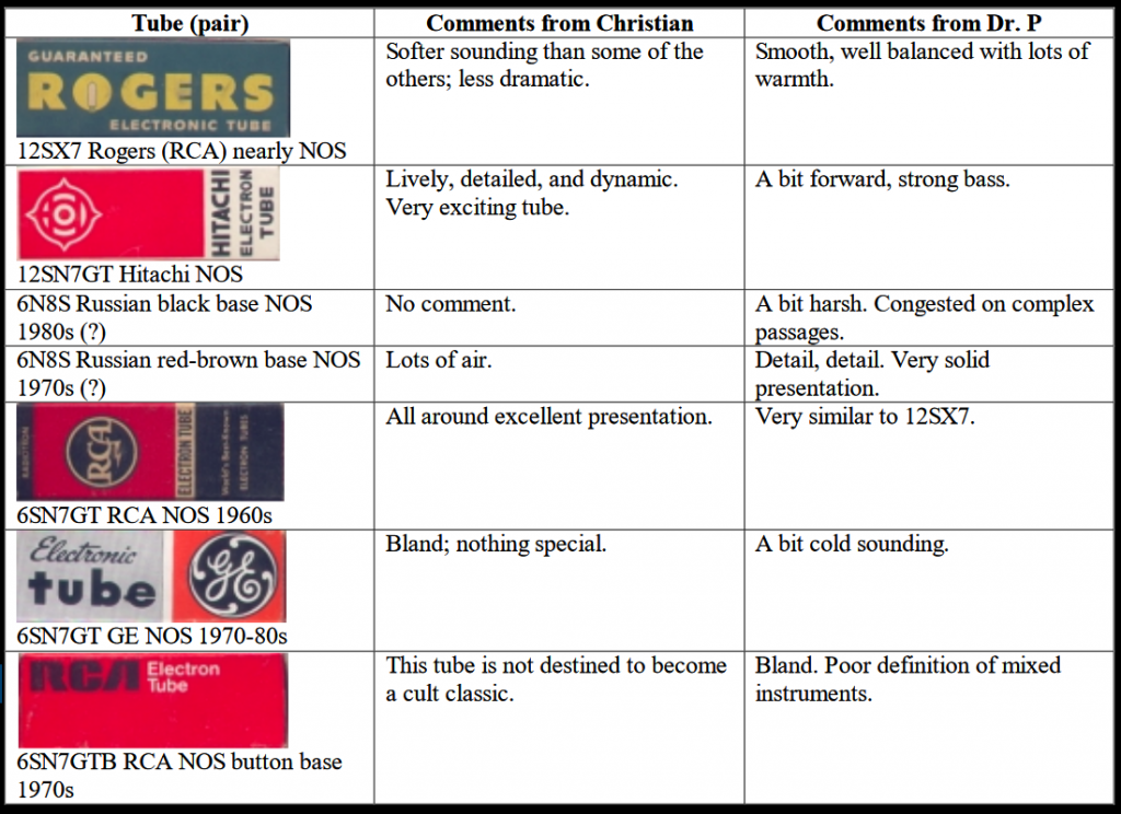

About 6SN7 etc check carefully this image.
Thank you FRM! If available on the internet would you please let me know where to find this?
Years ago I found this image, I no have the source.
Thank you.
