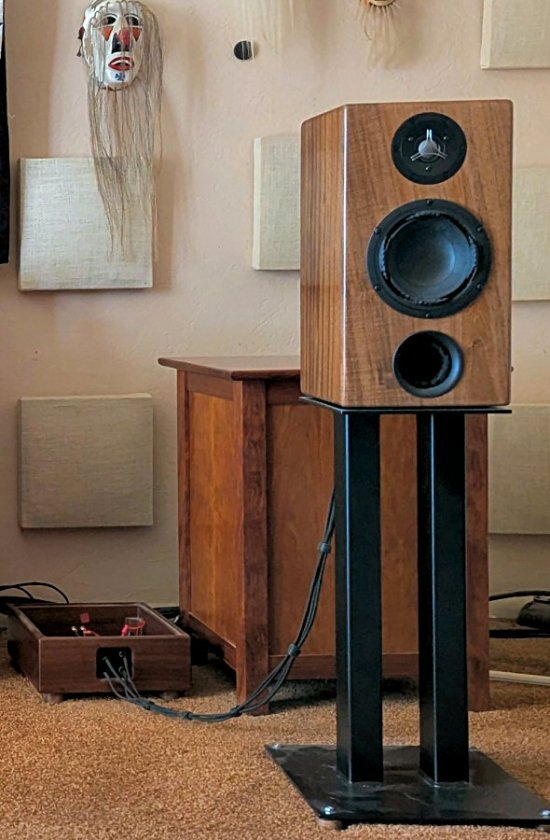

You can check out the Helios kit.
https://www.madisoundspeakerstore.com/2-way-speaker-kits/satori-helios-textreme-9.5-2-way-speaker-kit-pair/
I built the CM version that uses less expensive drivers, and love it.

You have to pay to have madisound assemble the crossover. The kit i got had just components. I needed to put them all together.
