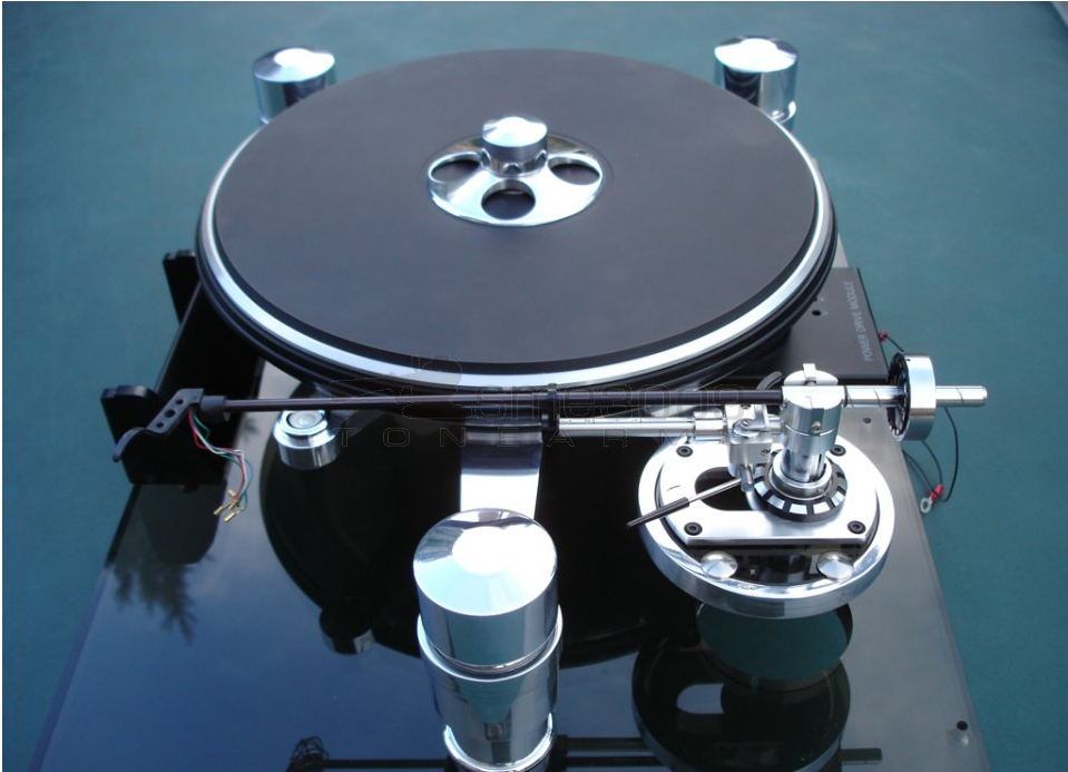

Not so much... This isn't my TT, but similar.

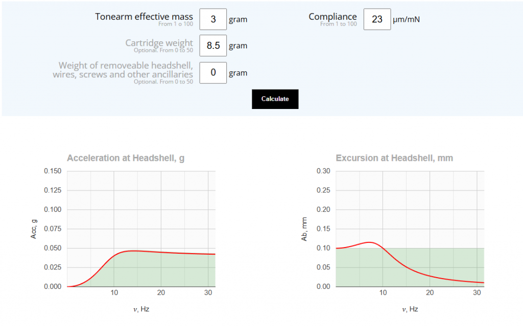

Using the calculator you provided here are some images;
ATVM95sml;

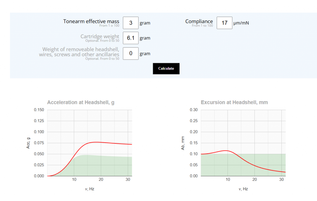

Shirley;

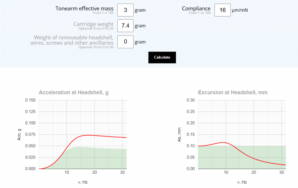

AT441SLA;

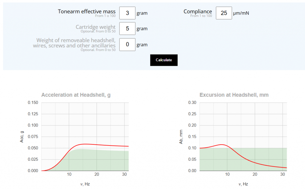

Ortofon VMS20E;
