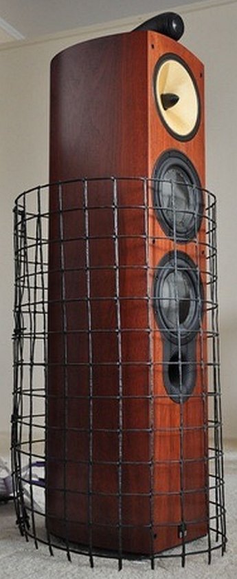

Stereophile, gave these a class A rating!
