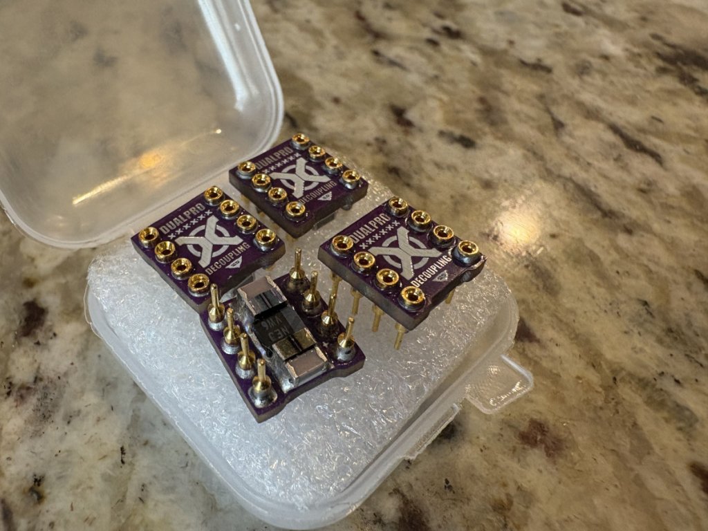

Opamp decoupling adapters with capacitors
After trying these decoupling adapters with various opamps, I was about to declare them not-worth-the-money.  They did seem to smooth out and bring down the high treble a tad, but this direction of change was not truly needed in these systems and opamps tested.  At the last minute, I decided to try them with the venerable Sparkos SS3602 because in the Aiyima T20, Sparkos sounded a bit overly treble-rich and airy, which tended to thin out tonal richness.  Otherwise, the Sparkos has great detail resolution, speed, extension, and soundstaging, all the audiophile goodies.
With the decouplers, the Sparkos seemed to move that high treble energy straight into tonal girth and richness, while retaining much of its resolution.  Tonal colors became more dense and less pale, more pleasant to listen to.
Still, these decoupling adapters aren't exactly cheap, so I would recommend them only to those in similar quandry with specific opamps in a given circuit.

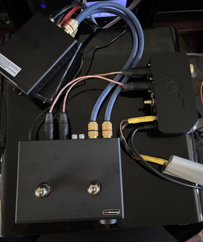

JakeJ
I joined the Chi-Fi ranks having just acquired the T20.  Some time ago I looked into building an office system made up of small footprint components.  I started by buying a Nobsound NS-02G Pro solid state power amp that is based on the 1969 Hood pure class A circuit using matched pairs of MOSFETs for the output.  Amp  Picked up a used Project DS2T CD transport.  Looked for a tube preamp but never did find a preamp that filled the bill.  Enter the Aiyima T20.  (JonL, thanks having the fever! :thumb:)  Sounds pretty good right out of the box.  Using a pair of PMC DB1 Gold monitors which sound good but at 87dB/W/m just a bit hard for the 10W/ch Nobsound to push.  I have others to try.
Added a Chord Mojo DAC but have a Khadas Tone 2 DAC coming as the Mojo is battery powered and it's bad juju to charge and play simultaneously.  Just kills the battery prematurely.
Running it in with the Psvane 12AX7 tubes then will start rolling some of my stash.  I'm watching this thread for some more tests and opinions concerning opamp rolling, which can be expensive in it's own right.
Thanks AC for helping me buy this year's Christmas gift for myself.  :thumb:
Apologies for the messy desk.
