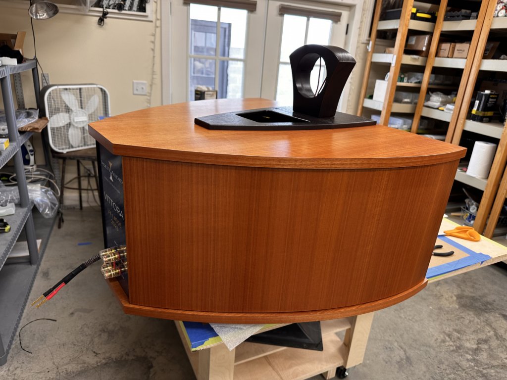

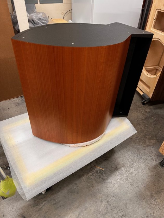

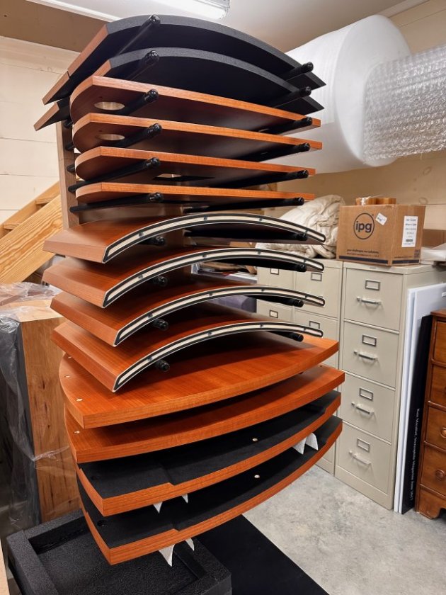

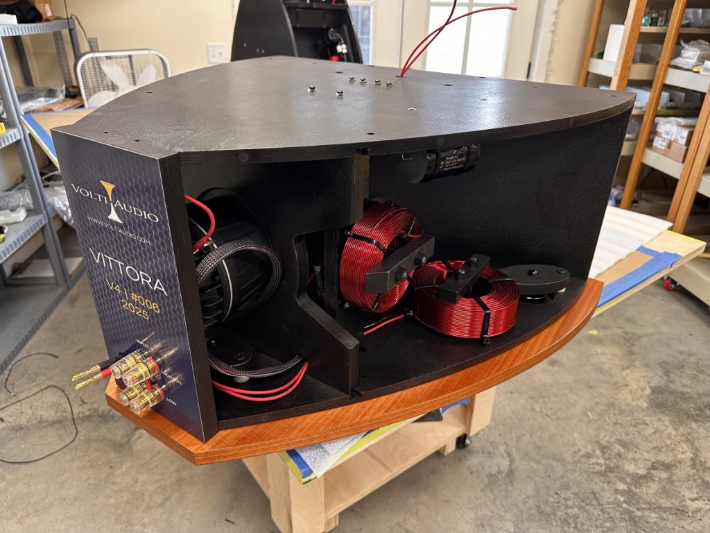

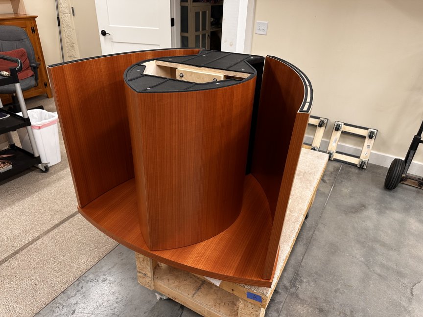

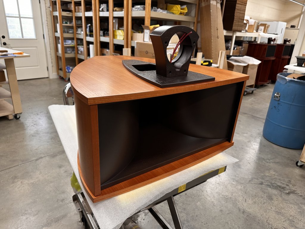

Another set of Vittoras is being assembled in the shop right now.  These are veneered in Makore.

« Reply #1 on: 24 Jul 2025, 05:54 pm »
Can you focus on the woofer area? As well as the Horn?

Think of a bass horn as a large midrange horn.  In the case of the La Scala or Vittora, that horn is folded in half, more or less, to make the cabinet more compact.  The pathway of the horn starts out smaller at the throat, where the driver is, and then expands ever larger until it reaches the mouth of the horn (front of the speaker).
