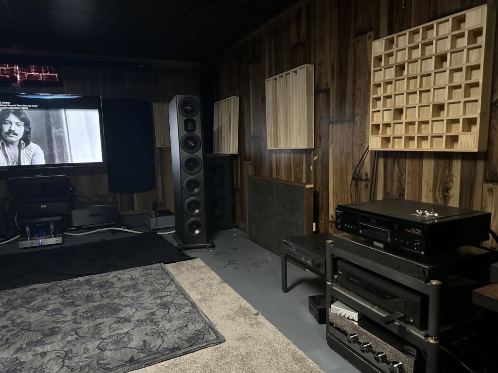

Anyone switch to GR diffusers after using other types? Thinking of trying some of the GR offerings.
This is the arrangement I have now that makes the speakers disappear, more spacious sounding. Though I don’t care for the looks. At least I might try GR diffuser for in front of the tv for listening to music.

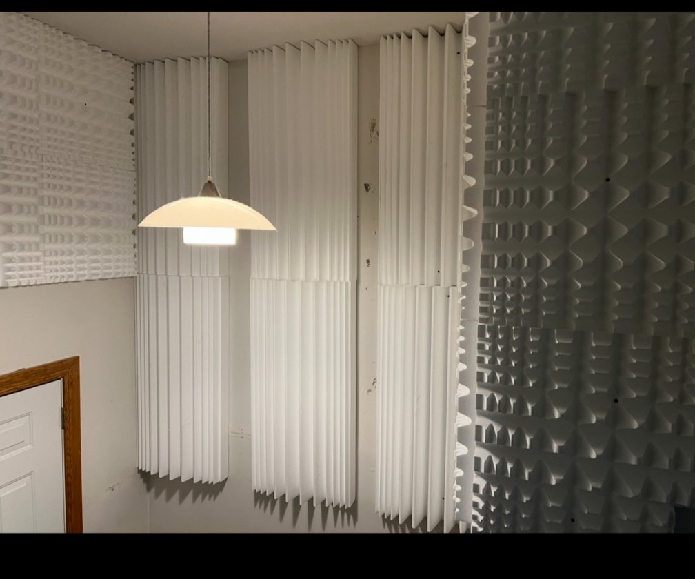

I switched from Sonex over to Danny’s diffusers. I find small details more noticeable. The soundstage has opened up and placement of instruments is more apparent. I am finally hearing my GR Bullies instead of my room. I highly recommend them. I don’t know how they compare to the ones that you have. They look nice, but I bet they are heavy.

Looks like you went all out, full room coverage. It should have made quite an improvement. My room is only 7 feet high with the drop ceiling. So not a huge amount of wall space. I Insulated between the rafters and the ceiling tiles are meant for home theater, so have some absorbing properties. I focused on placing the diffusers in line with midrange and tweeter MTM. Not sure if it’s the right way, but it’s an improvement compared to bare walls.
I might order one box of the 4 foot long diffuser to experiment with.

The deeper wells and wider faces of the slats on your QRD's will operate over a more broad spectral range than the GR Research diffusers. But, with the GR Research diffusers, you can cover more surface area for less money. So if you're trying to eliminate as much specular reflection activity as possible, the GR Research units are likely the better (more economical) solution. If you have specific areas you're targeting for diffusion...primary reflection vectors, in particular...the QRD's, with their more broadband performance, will be the better option.
