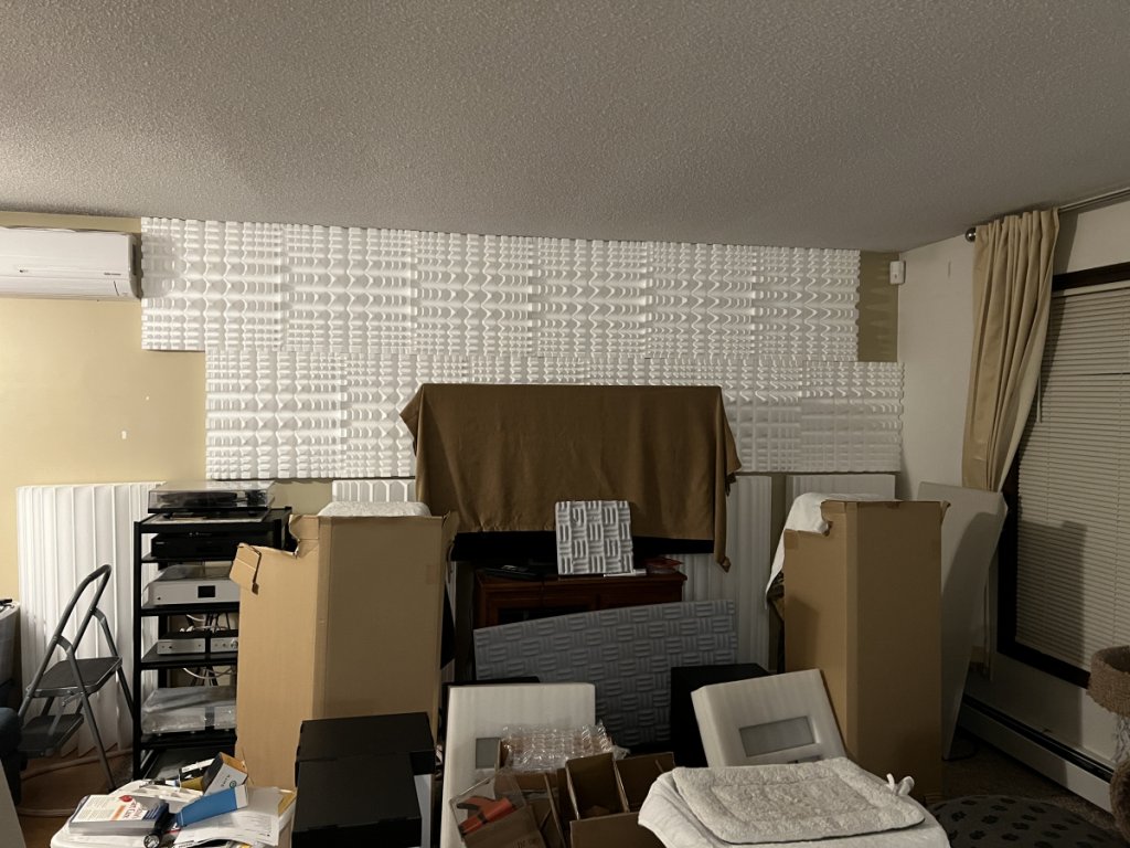

Ideas for Getting Bigger Scale from NX-Studios?
« on: 7 Jun 2025, 06:34 am »
I love my NX-Studios (build log: https://www.audiocircle.com/index.php?topic=188953.40 )
On occasion though, I wish the music coming out of them were bigger in scale. I’ve read that the BG Neo3 is in a way SPL limited https://www.linkwitzlab.com/frontiers_6.htm#Y%20- but I’m not sure if the GR Neo3 exhibits the same behavior. And if it does behave similarly, I’m not sure if that’s the reason why I sometimes feel the NX-Studios sound small.
Does anyone have ideas on what I can do to increase the scale of the music from the NX-Studios?
Footnote: My previous speakers were Klipsch Forte IVs and I liked the scale they presented. Would it be called a wall of sound maybe?
My impression is you have too much front wall damping, the drapes are absorbing the open baffle tweeter front wall reflections making the scale appear smaller.

I would experiment with broadband diffusion panels, either the diffusion absorption panels from GIK Acoustics
https://www.gikacoustics.com/product/evolution-polyfusor-diffusor-absorber-bass-trap/
or the PolyFlex diffusion panels from A/V Room Service to improve soundstage, air and spatial imaging
https://avroomservice.com/diffusers/

I totally agree. I'd move away from the "fully draped" approach and try a few of the front wall treatments mentioned above. Secondly, you can't compare a 99db efficient multi-driver Forte to a 2-way 88db NX Studio expecting the same dynamic scale and jump factor. I have two systems that somewhat display that very scenario. Horn loaded speakers in my bigger listening room and NX Studio Monitors in my small listening room. Each is excellent in their particular setting, but neither would work well if I swapped them between rooms. Your room doesn't look that big. I think the NX Studio Monitors would sound much more alive by letting their tweeter "breathe" in a less damped setting. Won't match the scale of the Forte, but just might be more satisfying.

I am in the process of replacing my Sonex foam with Danny’s defusers. I have only put them on the front wall so far, and they work! Background is much quieter. Details are clearer. Extremely worth it.
https://gr-research.com/product/diffusion-panel-sets/

On another note which might be the case IF that's a window lurking behind the drapes. Pull the NX Monitors further into the room and away from the wall. (or probably window) IOW, create more of a near field listening environment.

« Reply #10 on: 8 Jun 2025, 07:58 am »
Wow thank you everyone for the guidance.
My room is 3x4m or approx 10x13ft.
Yes unfortunately behind the curtain is a half height window on the left side. I’d like to avoid near field if possible.
Thankfully I have shipped in some of Danny’s 2D diffusers. Hope to make some time soon to place them on the front “wall” in between the speakers!
But yes I guess I do understand that I probably should not expect the same amount of scale as the Klipsch Fortes…

Danny Richie
Re: Ideas for Getting Bigger Scale from NX-Studios?
« Reply #17 on: 17 Jun 2025, 01:01 am »
I agree with WGH. Also, getting those speakers out into the room and away from the front wall will REALLY help a LOT.
