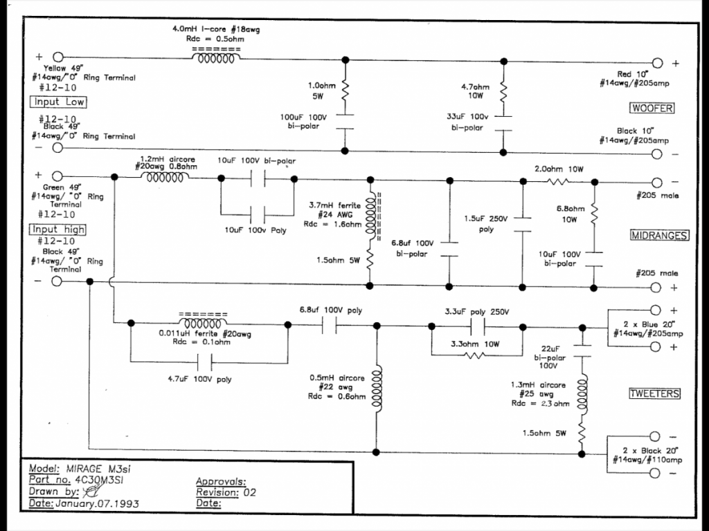

I have the M-3si's.  Great speakers, over 25 years or there abouts, never felt the need to trade them in for anything else.  But looking at them recently, there is definitely scope to improve the crossovers and internal wiring.  I also have a copy of the crossover schematic.

Here is the schematic
Not a lot of space in the cabinet either. I'm figuring on separating out the bass side and mounting it on the other side of the speaker, and hopefully there would be enough space for the expected larger components (caps, etc) for the mid and tweeter side of the crossover.

One question I have about potentially upgrading the crossover is one of the inductors in the tweeter circuit.
With the idea that you do not want any ferrite core inductors in the tweeter circuit, how would you upgrade this particular inductor, if at all.
It is in series with the tweeter, but it is exceptionally small, only 0.011uH  (11nH).  From the speaker parts sellers that I know of, there are no inductors anywhere near that small in value. (Did find air core inductors that small, 10nH, on digikey.com, but really unsure of their suitability/quality for audio or whether any differences in Rdc are critical or can be (or need to be) compensated for.  Here are the relevant details from the crossover schematic and photo posted earlier:
Thanks.  I appreciate your insight on this.
