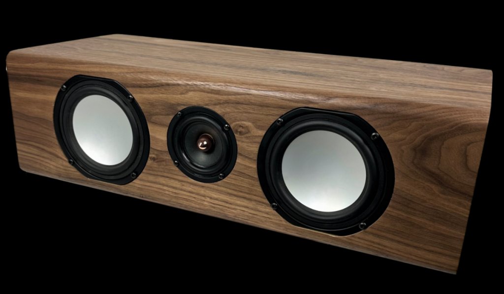

I am not a surround sound guy, so I am totally new to this. I want to get my mother a GR-Research LGK 2.2 center channel speaker to use with an Oppo 103 blu-ray player that I gave her.

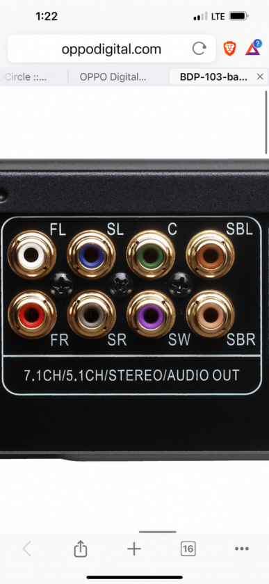

The Oppo has an RCA Center channel out on the back (green).
I assume that this is line level and will need to be amplified.

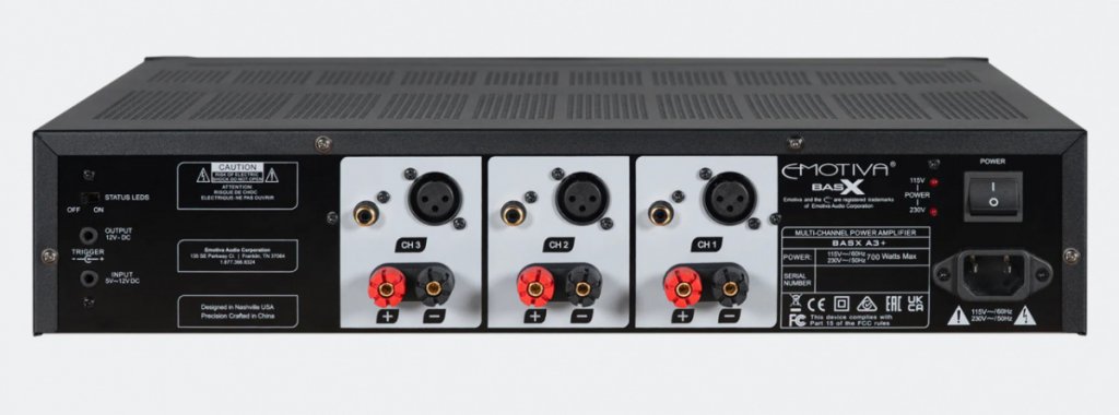

Emotiva makes a 3 channel amp for $650. The back looks like this:

Hey Nightfall 1970, sorry but WGH is wrong. You can use that player as an analog surround preamp which means that you can use that emotiva amp for a 3.0 system.  Seach Oppo bdd-103 user manual, page 27.
The hook-up is pretty easy...3 rca cables go from the oppo into the emotiva. Run the rca cables from FL (front left), FR (front right), and C (center). Then you just use the volume controls on the oppo remote to control volume.

Emotiva sells the BasX A3+ as the "Perfect upgrade for the front three channels of your AVR." First you will need a low powered AVR with line out (not all AVR's have line outs) and then add the BasX A3+ to add more power.
https://emotiva.com/products/basx-a3-plus-three-channel-power-amplifier

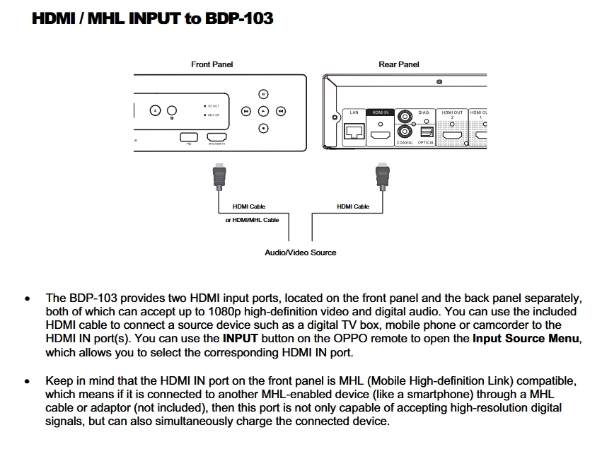

I have the oppo 105 and it sounds fine to me, cant believe the 103 wouldn’t be plenty good enough for the average person. Also, the 103 has two HDMI inputs and one optical input. You can use it as limited control center and probably sound pretty good with nice speakers. Good speakers are the most important part.

The Oppo BDP -103 has two HDMI inputs. I haven't tried them. The rear input may work from a TV, I dunno. You have to experiment. This is rarefied territory that not many people have explored.
I haven't found the optical input Glady86 mentioned, maybe he can circle it. I only see the Optical Out.

I thought the optical was an input, doesn’t matter anyway you only need to use the HDMI input. I use the HDMI inputs in front for fire stick, and the back one connects with Direct tv. You just have to use the 103 and an amp when watching tv and want to hear the separate speakers.
