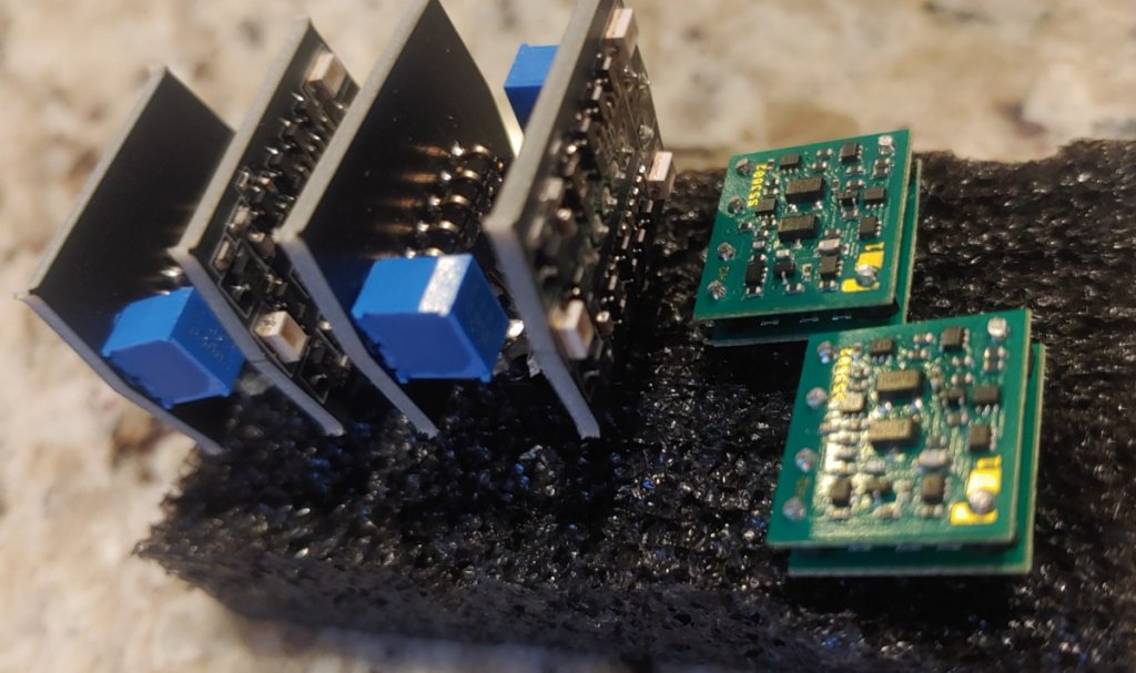

NewclassD Ultimate MkII and Sparkos SS3602 discrete opamps.
NewclassD made some GREAT stuff, extremely detailed yet extremely analogue sounding so far  :thumb:
