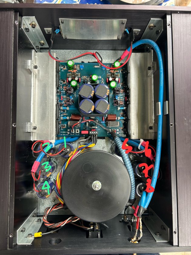

I have a pair o Monoblocks Odissey Stratos Extreme SN 3214 and 3215. I bought recently from a Guy in Canada (2nd. owner) but when I use them with my McIntosh C2500 premaplifier they cause a DISTORTION in all frequency range, when volume go up 40% or more than - 25 db in VU meters.
They were bought for use with a pair of LRS+ Magnepan Speakers and in near future with Magnepan 1.7x or Dipthique 115 speakers.
I want to get tested by a tecnician.
I live in ECUADOR, sud america so it is imposible for me to return back to seller or to Klaus.
PLEASE HELP ME!. Thank YOU

Is this not just some sort of gain issue, when you turn it up too much everything distorts. Sounds like too much gain issue to me.

Yes,  Please call me in the afternoon or evening,  for sure.
Right now I'm getting ready for Axpona plus dealing with some health issues in the family.........but first things first here:
1.  Are the amps getting hot ???
2.  Do you have a CD player with a volume control so that we can bypass the Mc ???  (make sure to turn down the volume before connecting)
3. If necessary,  they have to be rebiased....I can send instructions.
4.  Always email me directly at:  [email protected] , or,  alternatively at  [email protected]
Let me know,
Klaus

Hi Klaus, answers to your questions:
1. No, they run really cool.
2. I have a Bkuesound streamer that has volumen control to test bypassing C2500
3. I will write you to your email both of them but I prefer not to call because I am not so fluent in English.
Thanks

That preamp has 15db gain so pretty much the same as a Candela.

Hi, KLAUS. Thank you for answer me by email. I do all the test and distortion is still present. I know Mr. Nasau talk with you to make an upgrade to Kismet. I have a dude, the capacitors located out of the board near piltrom transformer (8 capacitors in each amp) must also be changed because of age, so I was wondering if they are included in that UPGRADE TO KISMET or have to buy separately, so what are the technical characteristics of that capacitors?
