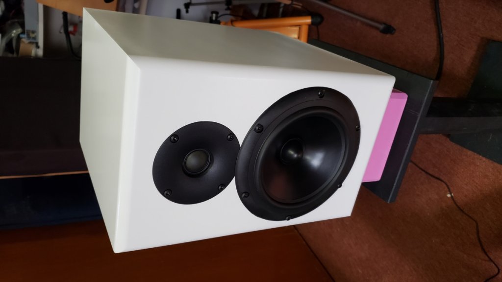

Here's some picture of the build. Nothing sophisticated. I build the cabinet from scratch using the plan on the web site. Minimal tooling: table saw, router and router table. I made rabbet on some panel to make the gluing easier. I made sure to keep the measurement identical to the plan.
I've used Bullseye 123 as primer, Wood Pro Filler and a water base Enamel from the hardware store for the top coat.
I learned the hard way that you should not use masking tape on MDF panel: it pulls out some fibers (microscopic) when you pull the tape which leave some mark that shows once painted (prime). All fixed with a little bit of filler.
Panels all ready to be glued:
Glued up:
Not sure it was necessary, but I put some noRez without the foam under the crossover:
Now the listening room. Why do I show such a messy room? Well. To show that you can enjoy music even if the room is not acoustically perfect. Small room: 11x15 feet. To be honest, the acoustic is not that bad. The sound stage is a little bit bias to the right. Now that I look at the picture, it might be caused by the few boxed behind the speaker on the right end side. I'll reshuffle these boxes to see if it fixes the issue.
That's it for now.
