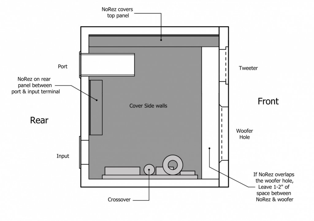

jmimac351
Re: What’s up with No Rez Danny?
« Reply #4 on: 20 Feb 2025, 12:34 am »
Most of the times I've come across "too much" NoRez when working with customers, it's often an issue with smaller speakers where the foam layer is pressed right against the frame of the woofer, (or overlapping the woofer hole) so the woofer is having to play "though" the foam layer where it leaves the speaker sounding a bit "stuffy" or "boxy."
I can see a similar issue occurring on our tall, narrow models, like the NX-Otica as well.
On a really big box speakers, with a larger driver, it's a lot less common of an issue.
I always recommend leaving a ~1.5-2" gap gap between the NoRez and the front baffle/woofer which will allow it to breathe freely.
Funny, you made me think of the new NoRez and whether I should use it instead of the original version for a project...saw this drawing explaining what you mentioned:
