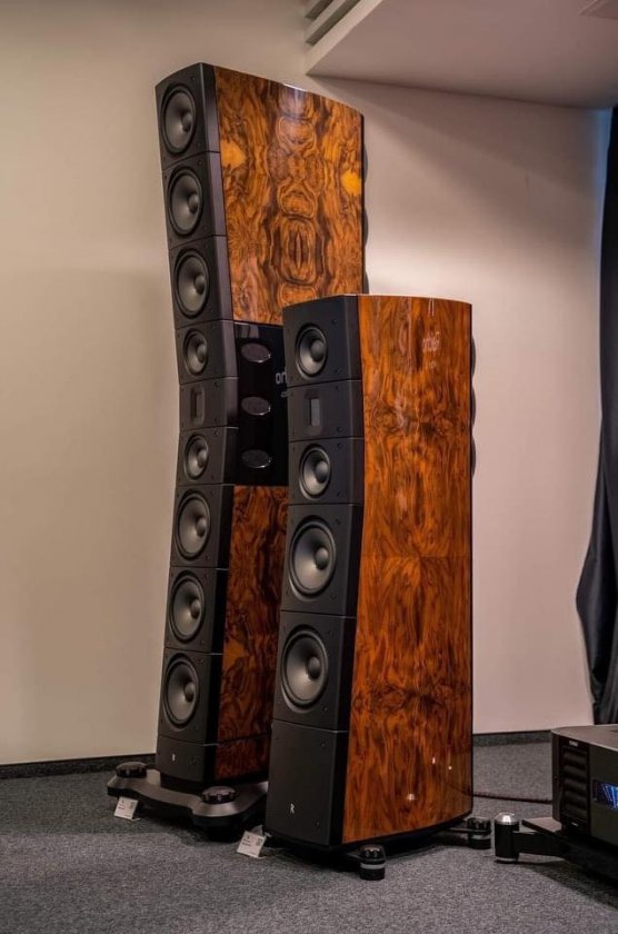

I personally wish a narrow baffle, full range loudspeaker existed... in a box.
You know... like an NX-Treme... IN A BOX.  An NX-Otica... IN A BOX.  A legit, tall, BIGLY... FULL RANGE speaker...
Hmmmmm I think something like that has been done before
Yeah...now why does that look kinda familiar?
