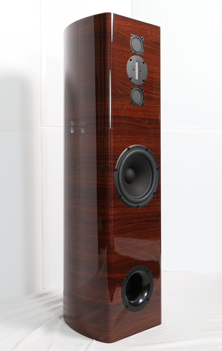

Did you pick the X-Static because of the price? reviews? frequency response? or efficiency? $1,109 is a bargain for a full range speaker. The Philharmonic Audio BMR Tower has a front port and is also a bargain but it is also 4X the price at $4,400 pr. Dennis Murphy is a world class speaker designer and crossover wizard.
https://philharmonicaudio.com/products/bmr-tower
Frequency Response      25 Hz - 20kHz (+ 1.5 / - 3db) Anechoic
Sensitivity    86 dB (2.83v/1M)
