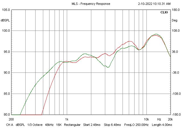

Out of curiosity, can the wave guide you are selling be used without the back cup for open baffle?

Not without affecting the response of the tweeter.
(Green is without the back cup, red is with)
Thanks. Is it possible to 3D print a similar waveguide like the one used for the NX OB speakers?
