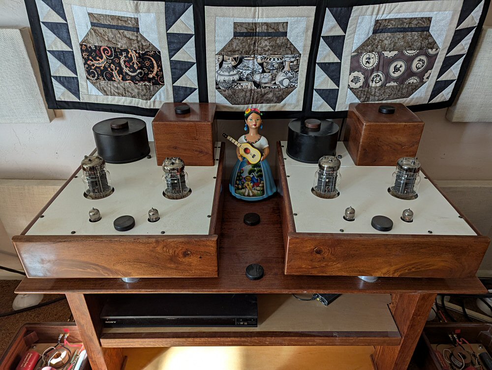

The McGary Audio SA1E amp is 30 watts per channel, by coincidence the custom tube amps we listened to with the Purifi-Be speakers were also 30 watts per channel. The mono-block amps, preamp and phono amp were designed by Kevin Carter, owner of K&K Audio, who recently passed away. The amps are clean and powerful without the classic tube sound although the speakers still need to be tube friendly. I recently listened to a restored Dynaco ST-70 amp and the K&K amps sound completely different and modern.

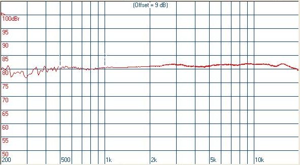

I think the difference is perceived bass compared to actual bass. A speaker with an extended high end like the BePure1 will need an extended low end to feel balanced. Room size is important too, a large room will require a lot more bass energy than a couple of 6.5" drivers can produce. Yesterday our audio club listened to a pair of new Magnepan 2.7i speakers that have a true ribbon tweeter. These speakers have the clearest, non-fatiguing mid and high frequencies I have ever heard, they are -3db at 40 Hz but still need a sub to sound balanced. We listened to the 2.7i's with a REL Gibraltar G2 sub.
All the frequency response graphs of Salk speakers have been very flat, I would expect the BePure1 to be flat also. I haven't seen a graph for the BePure1 but the Salk website has a graph for the BePure2

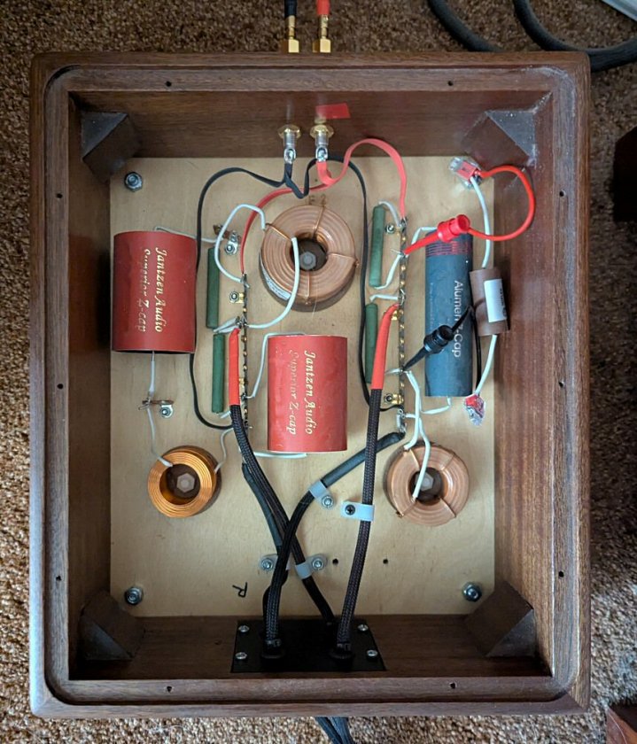

I'm using the same 2 drivers as Troels in a similar sized box on a Joseph Crowe baffle, but sealed box with subs below. An engineer at Purifi I reached out to prior to building mine confirmed to me going sealed box was preferable. His personal diy speakers use them sealed box. I don't know why folks want these little woofers (any brand) in small boxes to play deep bass. Ports or passive radiators just add smearing, timing and phase issues to (sort of) make deeper bass, but that's a different discussion. :D

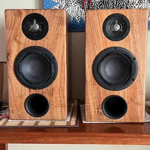

Please post a pic of your speakers. Thanks.
Sorry, I'm not able to upload an image from my phone in the vertical orientation from my gallery. I've tried to resize it and rotate it in the gallery but it doesn't take. Keeps coming up sideways.  :dunno:
If you post it (whatever the orientation), I can rotate it.

Charles flipped the image. I deleted the sideways one to keep the thread clean.
Drivers cost the same as your build I imagine (less maybe, built these 3 years ago). The baffles from Joseph Crowe cost about $450 shipped from Canada. CNC cut 2.5" Walnut. The boxes are Baltic Birch. There's a video about them on his YouTube channel.
Wasn't trying to derail the Troels thread, just pointing out my familiarity with this driver combo and some of the potential issues with putting the Purifi woofer in a small box and reasons why the Troels speakers sound different from the Fritz in your friend's system.
