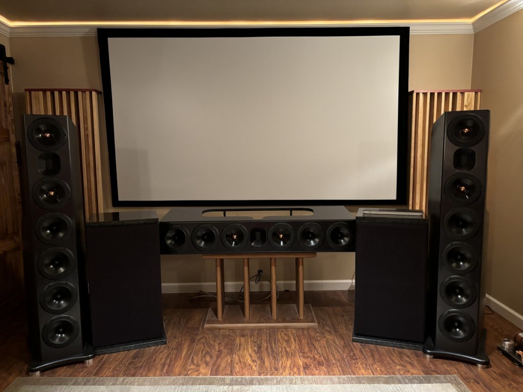

My TV space has 13 speakers which is mostly Bully and and XL-S Encore. My music listening space is the Oticas and Double Trouble. I stream roon music to both spaces and I cannot choose a favorite. I really like them both.

Impressive setup. Thanks for sharing the info and photos. I certainly do get that the GR speakers bring a lot of value to the table too. Lots to cogitate and chew on.

Interesting take on things. Sounds like a great batch of systems you have.
