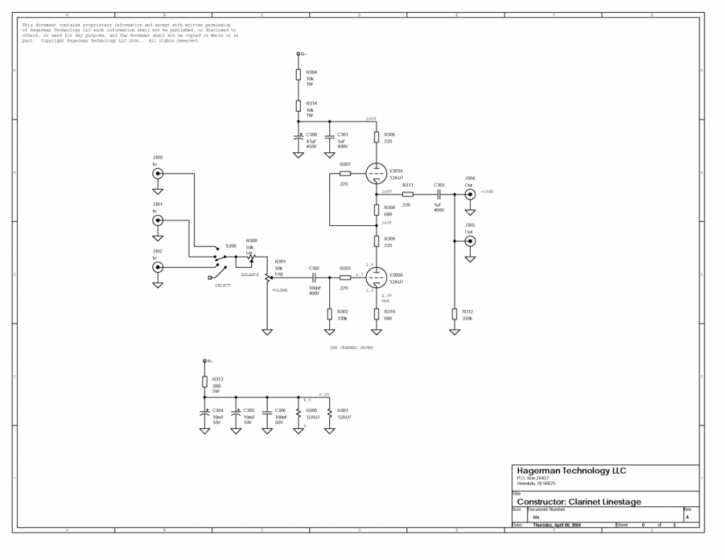

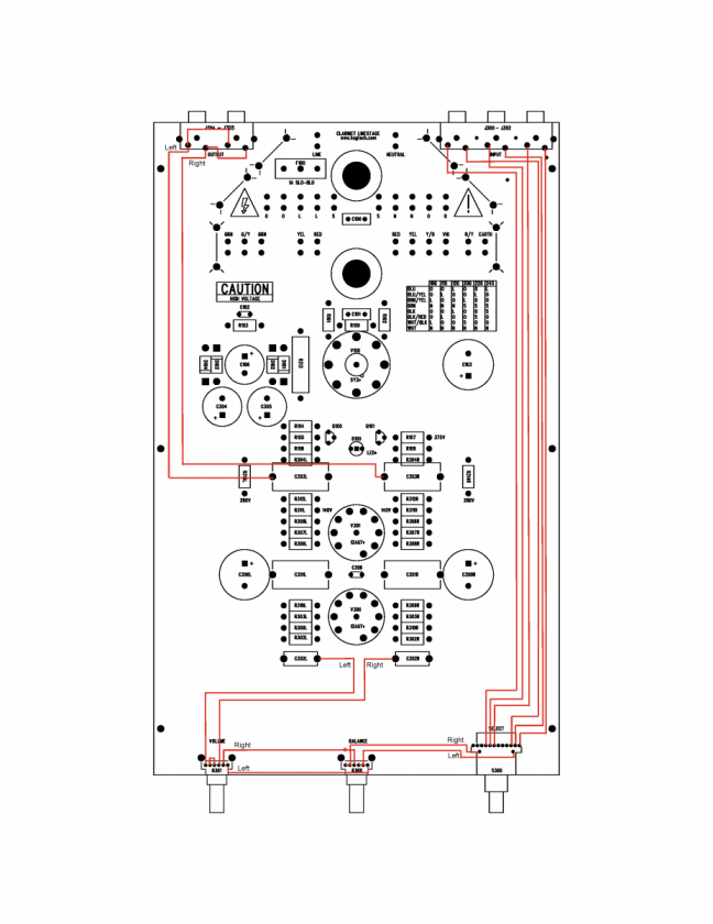

I picked up an old Hagerman Clarinet PCB a while back and am building out using offboard RCA jacks. I've traced the inputs to the selector switch and outputs to the output jacks (drawing attachment). If I look at the stock RCA jack assemblys though, it looks to me like the R/L switch at some point (solder pad on the input doesn't correspond pattern wise on the PCB with the output pad). I'm probably reading it wrong, but if someone with better eyes than me could take a look I'd appreciate it.

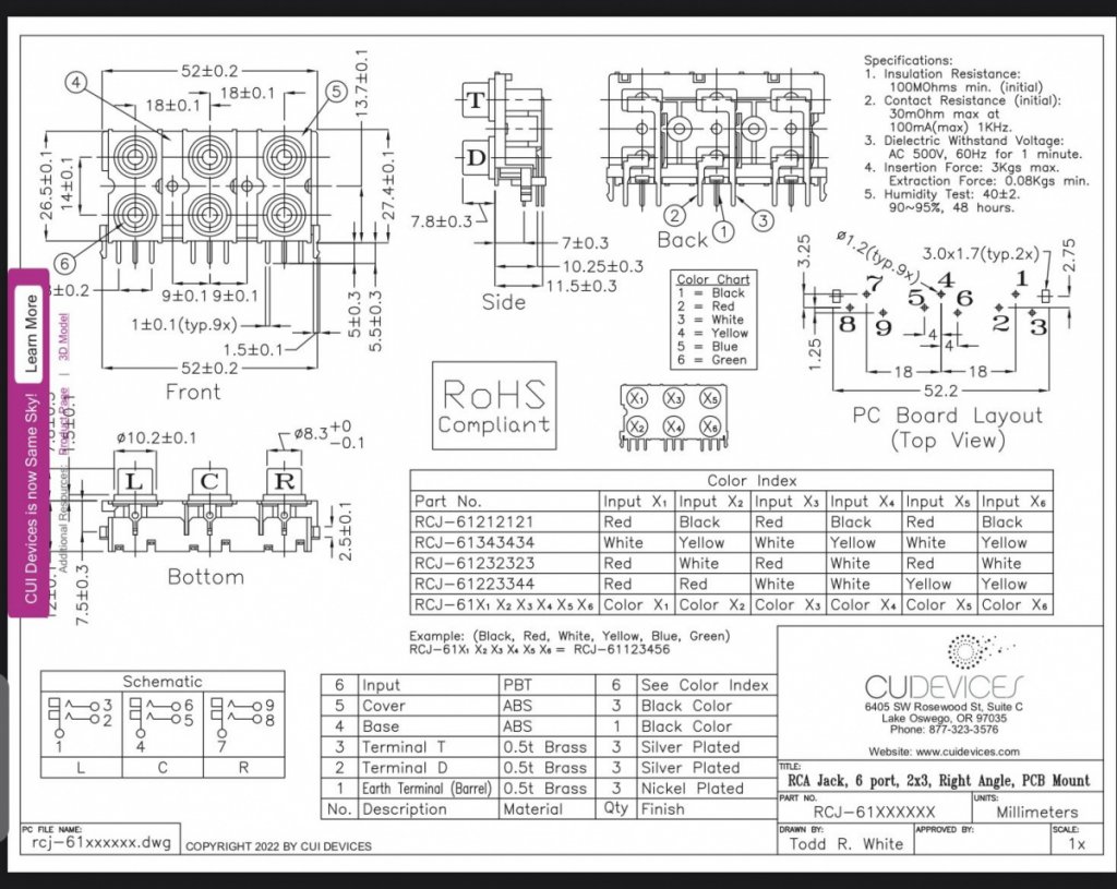

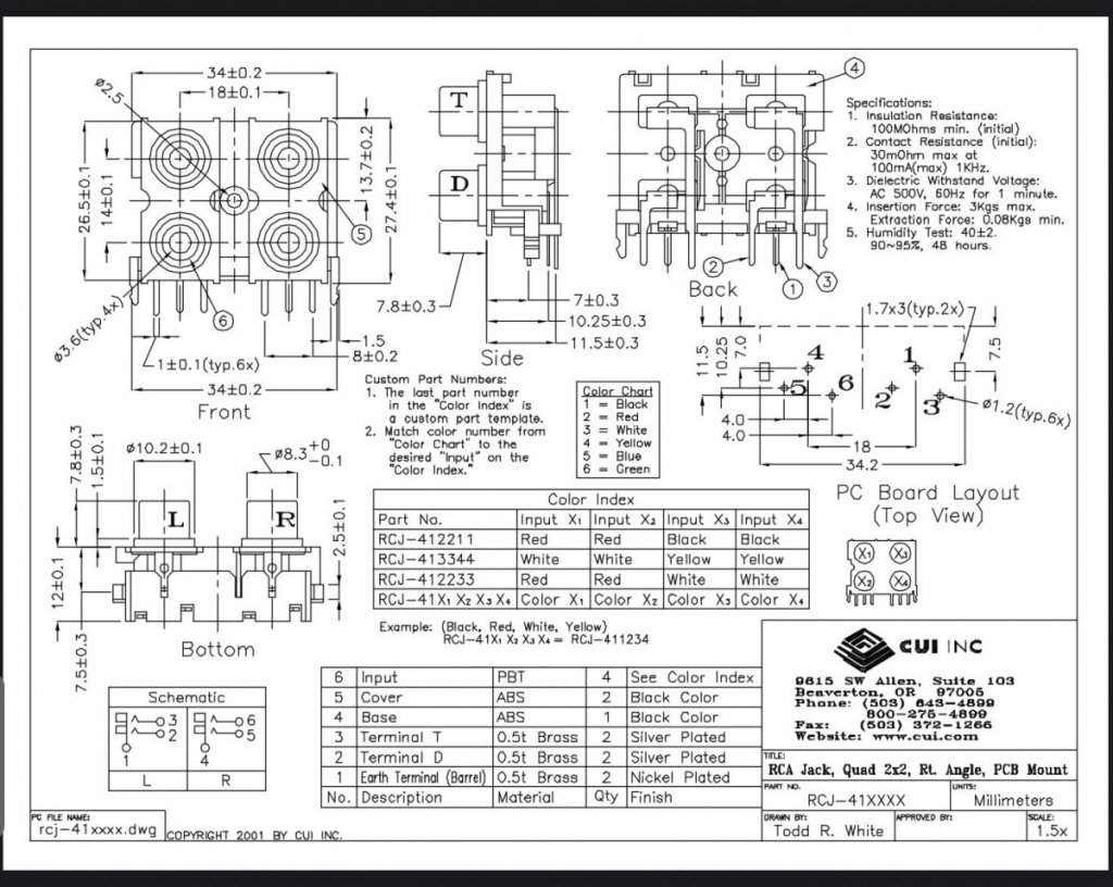

I’ve been reading the posts and looking at pic for years. I bought all the parts nearly 15 years ago. What I’m not using is the rca assemblies that worked with Hagerman’s chassis. I’ve had the board populated for a while, but just unsure on the RCA jack connections as I’m using individual RCA jacks, not the assemblies. . If you look at the way the RCA assembly input connections  work it looks to me like you’d have to have individual Rcia jacks wired opposite of the output to follow the left/right channels all the way through. I’ve seen them wired this way as well as with the configuration matching. I’ll try to doodle up what I’m actually saying as it’s confusing to try and explain.
Blooze
Re: Hagerman Clarinet PCB Inputs/Outputs
« Reply #6 on: 27 Oct 2024, 12:46 am »

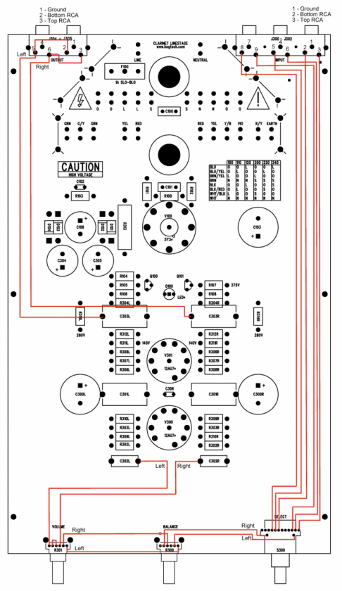

Ok. So here's what I see. If you follow the output RCA's back to the Input RCAs.
Pins 2 and 5 are the bottom row of RCA's and the Left channel.  We'll call them White. Pins 3 and 6 are the top row and the right channel and they are red.
This tracks all the way back to the switch.
From the switch to the input RCA's: Pins 2,5 and 8 are the Right channel, bottom row, white. Pins 3,6,9 are the left channel, top row, and red.

I think you got it.

I think you got it.
Thanks for looking. I guess I’ll just wire the individual RCA’s to follow left/right from input to output instead of them being “swapped” like it is on the pcb.

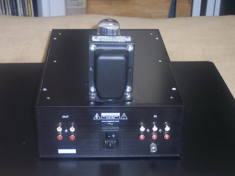

In a horizontal layout like my amp, the RCA Left channel is on the Left and the Right is on the Right when when I'm facing the front panel, this makes sense to me because I can't get behind the rack to read labels. Of course if I was plugging in interconnects while looking at the back panel the L&R would appear to be swapped.
In a vertical layout like the Clarinet the Left is on the top, the Right (red) is on the bottom. The two RCA Outputs are wired in parallel so the only L&R is top and bottom.
What we need is a picture of the Clarinet's rear.
