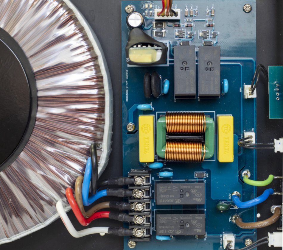

The amp combo looks like sculptures and a piece of art which is great on the eye but gives me a little bit of a headache at the moment. There is a buzz on one of the Evo-Two amps since moving the device around some days ago and I would like to have a look inside for a potential initial diagnosis. Although I am good with electronics, I seem to come to my limits understanding the beautiful casework of the amps. I simply don't manage to open the top plate for an inside inspection. I have loosened the four (main?) screws of the backplate near the edges which I thought are key to removing the top plate. But removing the four screws doesen't see to release the top plate or anything else. I don't want to test with more force whether I can make it move in the absence of a deeper understanding how the entire case works. I don't want to disassemble the whole thing, I just want to remove the top plate and I wonder where I'm failing to understand how the case works.
Could anybody who has opened an Evo-Two amp before or a Nuforce/Nuprime product with the same principal casework design please enlighten me how I can accomplish the task of removing the top plate?
Are you hearing the buzz from the speaker or the amp's transformer?  This is either grounding related or something become loose (ie transformer).
Please wait for instruction. Normally you remove the 4 bottom feet (use your hand friction) to expose 4 screws under the feet. After removing the bottom plate, more screws are exposed. The top cover is connected and secure of screws from the bottom.
Don't do it until we upload the instruction.

From your description, I am quite certain it is from the big transformer that became loose.  Transformer has natural frequency of 50Hz (Europe AC).  Even though it is tighten and glued during shipping, if it is bumped around (even if there is no sign of damage on the packaging box) the inertial force could loosen just a little for it to hum in its natural frequency. There is a big screw at the top of the transformer where you can tighten it.  Even if you don't, the sound won't affect the speaker.

Thank you for the photo, which makes it easy to locate the potential source of the hum. Equipped with the first info on entering the case from the bottom side and the transformer picture, I feel that I'm now equipped to carefully approach this. I will report here about the results.

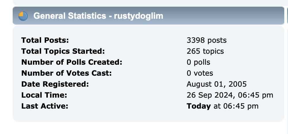

OMG, I have been on this forum since August 1, 2005  :thumb:
