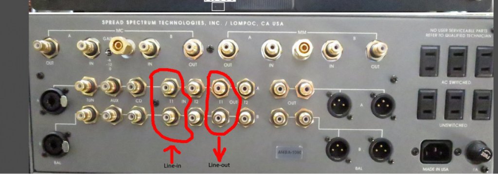

I'm still a bit confused as both tape loop are marked as out. So should I connect the tape loop out from the SST Ambrosia to the input of the Nakamichi? I presume this would record whatever source you are using?
And then connect the output of the Nakamichi to the input such as a Tuner (that is all I have left) on the SST Ambrosia?

Have a look at the attached image, let’s just make sure we are looking at the same thing first?
If we are looking at the same thing, I have picked T1 as an example, you have both In and Out. If you look at the image, the one circled and labelled line-in goes to your tape deck line-out. The one labelled line-out goes to your tape deck line-in.
You can use either T1 or T2, but whichever one you use has to be the same one for that tape deck. I assume they are labelled T for tape.
Not sure how you selected the source and record on the front, but you need to work that out yourself as I know nothing about this pre-amp.
