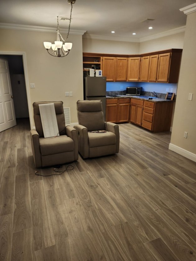

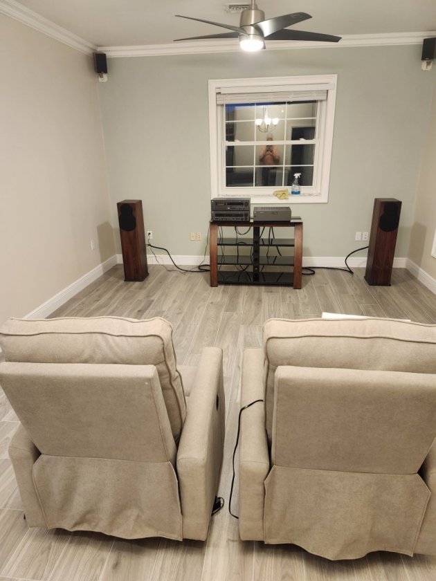

Here are a few pictures of the space; If someone can tell me how to rotate the images (step by step), I will.
Ignore the little speakers in the upper corners of the room. I put them up there 30 years ago and I haven't tested them in at least 20.

I have added carpet and curtains. I took REW measurements along the way.
Here is what the room now looks like;

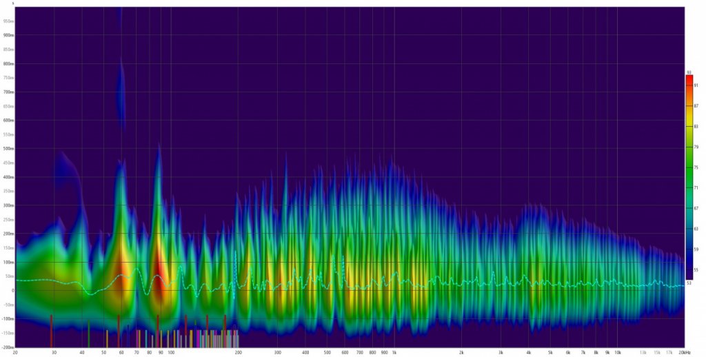

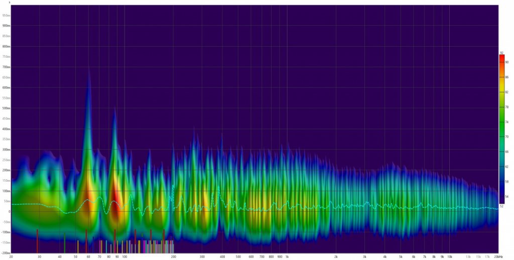

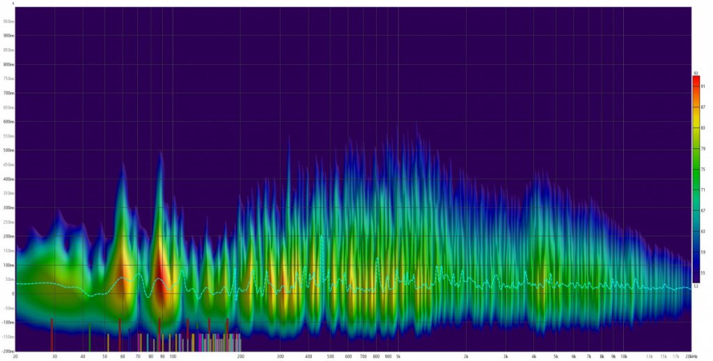

Here are Spectrograms from along the way;
Empty Room;
Carpet Only;
Carpet with Curtains (open);
Carpet with Curtains Closed (The picture above);
