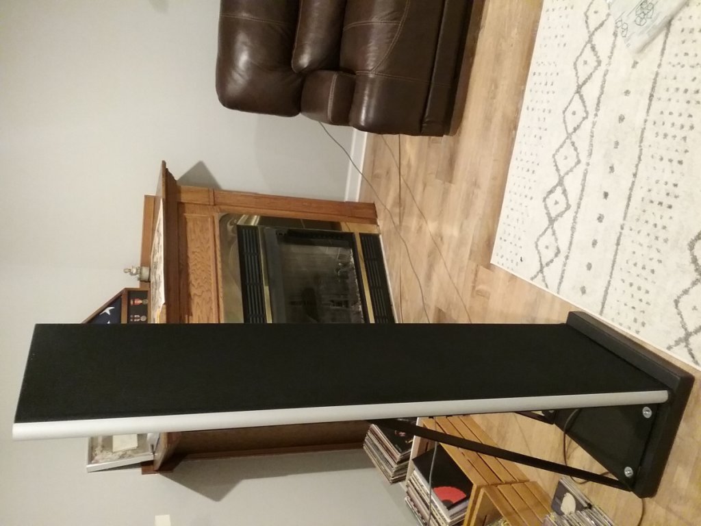

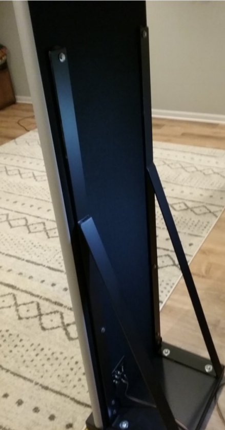

Tomorrow Ill start setting up my system. Musichall mmf 9.1 tt, Soundsmith Zephyr lll cart, Bluesound Node 2i streamer w ext. lps & dac, Carver pre amp, Odyssey Stratos amp, Magnepan 1.7i speakers.
In last setup soundstage could be very good depending on recording, but never achieved "speaker disappearance".
It is a fairly lively room. I tried "poor man" absorbtion with blankets at 1st pts of reflections which helped livelyness a bit.
Im thinking about diy quadratic diffusers for front wall behind planars. Considering about 700hz to 3khz frequency range.
Any comments on this or how I can make speakers "disappear" . No silly jokes please.
Ill try to attach old pic of speaker stand mods. May give abetter idea of room.

Sorry about the sideways pix. My smartphone techniques need help.
Forgot to include Rythmik servo sub. May look into bass traps too as very deep bass gets boomy at times.
Anyway, that looks like a great price for the Accustic Fields plan. Let us know results.
I just want a quick, easy and inexpense project as my time is very limited and I have big poly caps waiting to upgrade the xo's in the 1.7i s. Im considering a project on diyaudio by bwaslo 2015-2-7. I do question the freq range he gives 400hz to 8k hz. Seems like deeper and much narrower wells needed for that range, but others who built it claimed noticeable results.
As my 1.7i  planars radiate from the back. I think a rear diffuser is a worthwhile start for room treatment.
