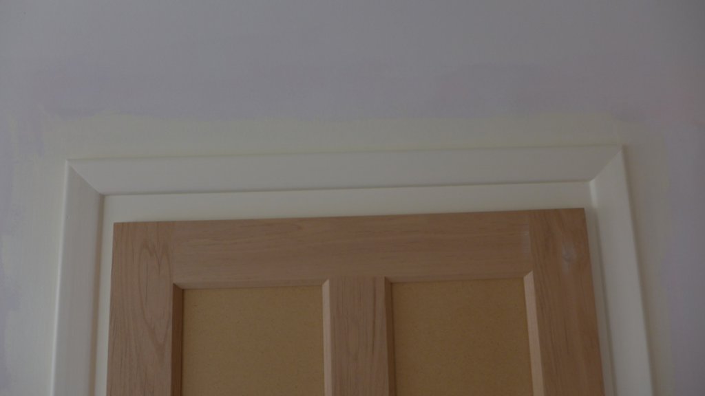

I tried to photograph this to show texture and sheen but I'm afraid it just doesn't translate well compared to naked eye. It's satin Cabinet Coat which is really similar to the mentioned Ben Moore product. FWIW, I guess.
