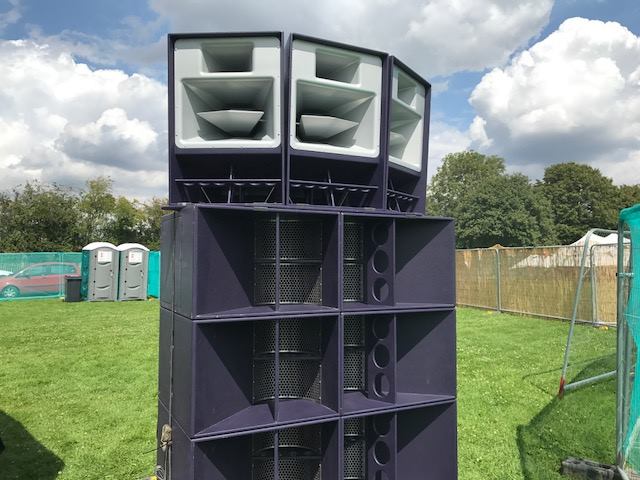

a design I had in mind and would really like to build eventually contains either 3+ tweeters or other driver (purely because it would look nice). Now I also have seen some videos and a forum post on this subject stating that it won't work and in fact that it would be worse than just a single tweeter (or woofer) due to comb filtering. I understood the information and kind of accepted that the design idea would never work. but then I thought about speaker setups I had already seen at festivals like this:
maybe im totally wrong but this looks like multiple sources of sound next to each other playing at the same time. wouldn't this than also "not work" because of things like comb filtering? or are they using some other strange technique to combat this? I would love to hear what you guys think because maybe in the future I can still work out the idea I had

PA speakers main purpose is to play loud, secondly to offer wide dispersion.  The design shown would seem to accomplish both.  Tweeters are very efficient and wide dispersing so multiples shouldn't be needed for home or studio use.

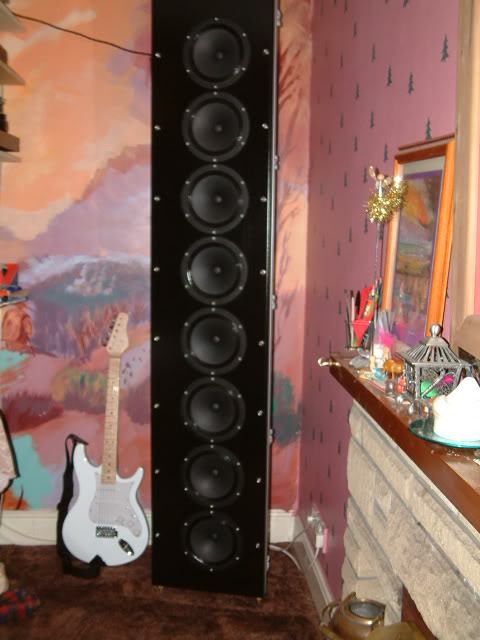

If you want a line array to large sound-stage consider this project made by a AC member years a go, it use 8 Visaton B200 in serial-parallel or you can connect all 8 drivers in parallel to 48 ohms and order a 45/47 ohms OPT to your tube amp.
This is a very musical speaker(hence no cross-over), sweet music and great sound-stage and power handling.

In an ideal world. any 2 drivers would be within a quarter wavelength centre-to-centre. Vanishingly few tweeters will allow for this. At that point there is no lobing at all.
A PA system has quite different requirements than one for home hifi.
