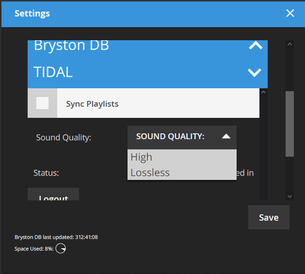

Now, on TIDAL, you have better sound quality at your disposal. Listen to your favorite classics or discover new milestones in HiRes FLAC……
Explore our HiRes catalog and discover the difference with TIDAL… and this is how it works in the app
Does anyone know why my BPD-3 doesn't show me music in HiRes, and only does it in CD 44100 quality...?
Thnx for reply and helpme.

open MM and click on the media player settings
Scroll down to Tidal and select lossless ......click save
That should fix your issue.

Hi friend,, I already tried that before coming here.. the result was NOT satisfactory… :nono:

I notice on the web UI for Tidal app now that the highest res tier has been collapsed into
the high tier (as of Apr 10) that 24-bit 192 kHz is not available for any of the songs in
my playlists.  MM reports the same info even though I also have it configured for lossless.

So are the options in the drop  built by what is offered up by the service?
My Qobuz dropdown has:
Lossy
16 bit lossless
24 bit lossless
Studio
Edit:  just found out, with Qobuz, If I have it set to 24 bit lossless and search on Charles mingus and play his Ah Um album I get a 24/96 stream.  If I change that to studio it get 24/192
So guess I answered my own question  :wink:

TIDAL hasn't given us access to to anything higher then 44/48khz 16bit and the TIDAL integration will eventually be replaced with TIDAL Connect as TIDAL is pushing in this direction.
