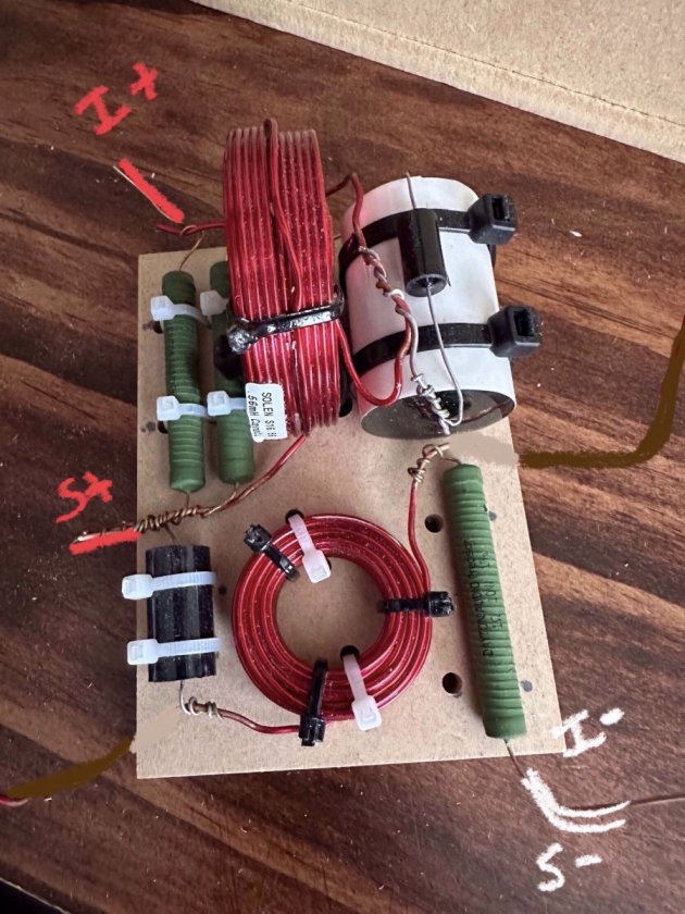

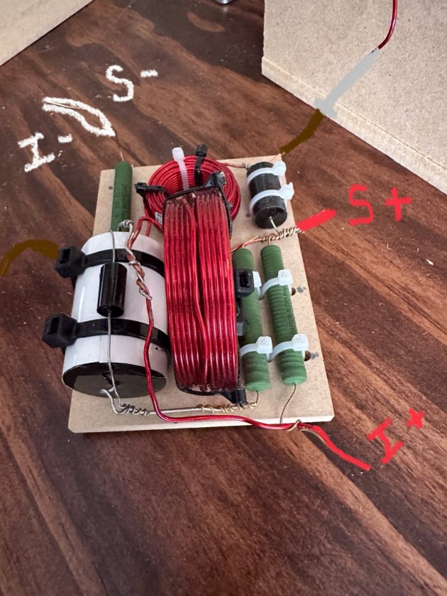

Hey Gang. Just getting around to building my LGK 2.0's. I'm organizing the crossovers using a post by E-ZEE. Can someone let me know if this is good before I start soldering. I don't know electronic symbols, so I used "S" for speaker, and "I" for input. Can someone tell me what "W" stands for?

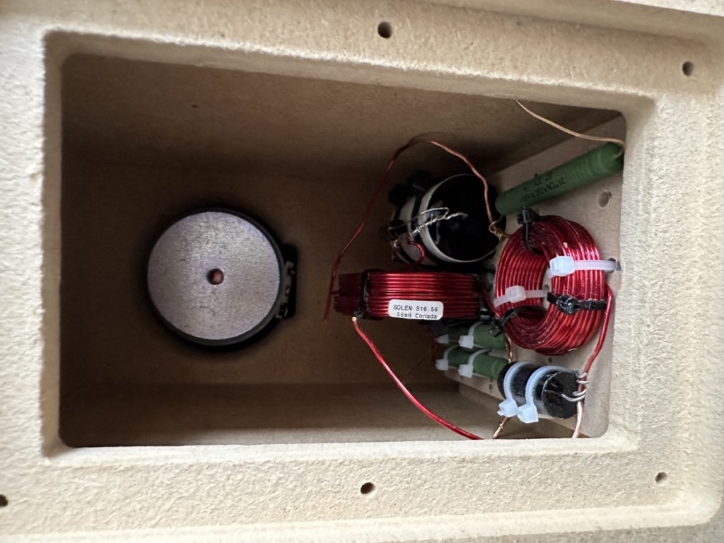

Also, is it OK to put the large coil towards the front. If I put it in the back it interferes with the connectors. I could mount the connectors high though. Picture attached.
Thanks!

Dont forget to strip the red coating in the Inductor leads. I am not sure if it is just the photo but it seems that the big inductor needs to be stripped. You can use sandpaper, a cutter or a dremel tool. Thanks.
Frederick

Thanks Frederick. I'll definitely strip the red coating off before soldering. I haven't made that connection yet as I'm planning on slipping a piece of shrink tubing up on the solder joint higher up on that lead. I need to start building the cabinets. Out of town this weekend, but by next week things should start to happen.
