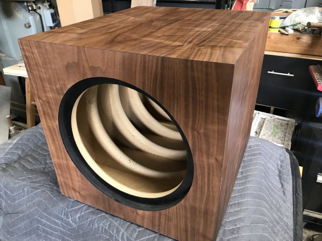

I’m getting close to finishing the cabinet for a matching sub. I put the first two coats of oil finish on this afternoon.

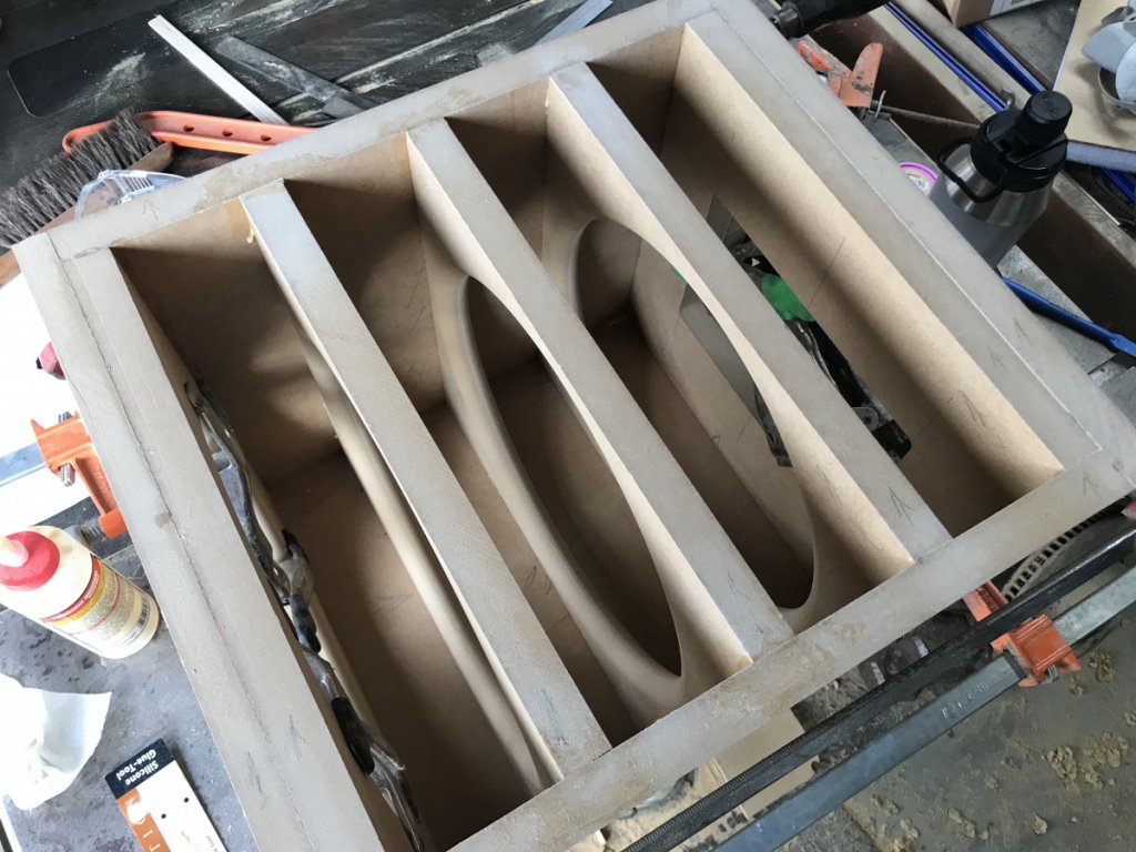

Now that is a very well braced box!
Nice work on the veneering.

Thanks. I should finish this weekend.

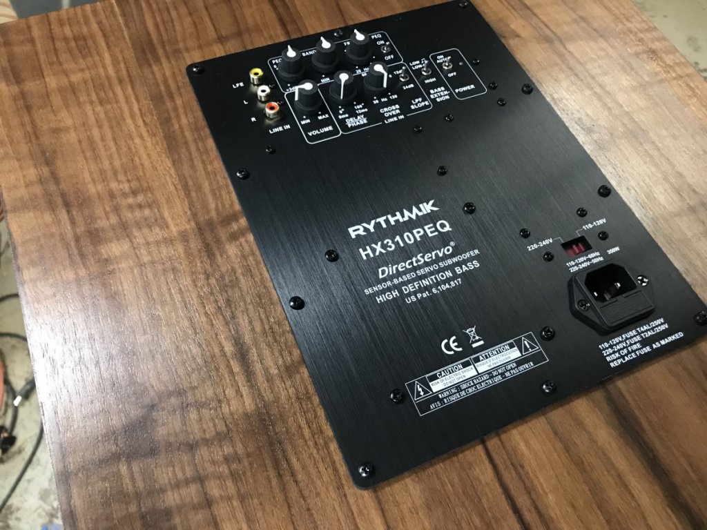

Hey Kurtloup, is that one of the sealed servo kit flatpacks from GR or did you make that cabinet from scratch? Just ordered one of the flatpacks and have been thinking about how to integrate the plate amp to the back.

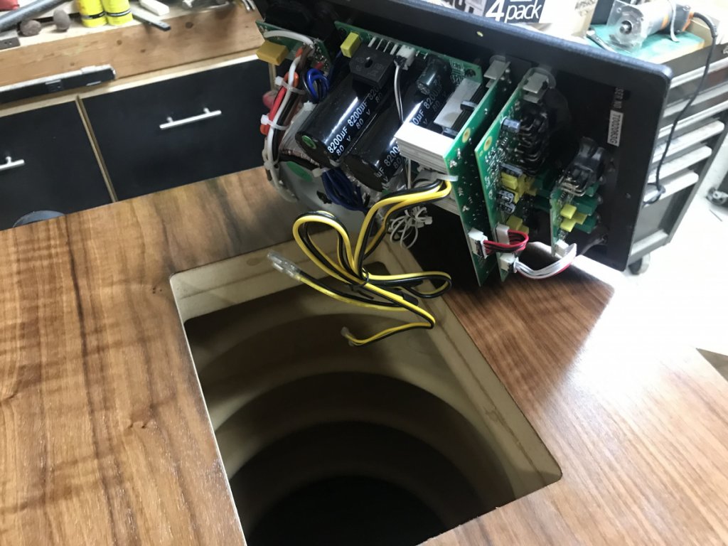

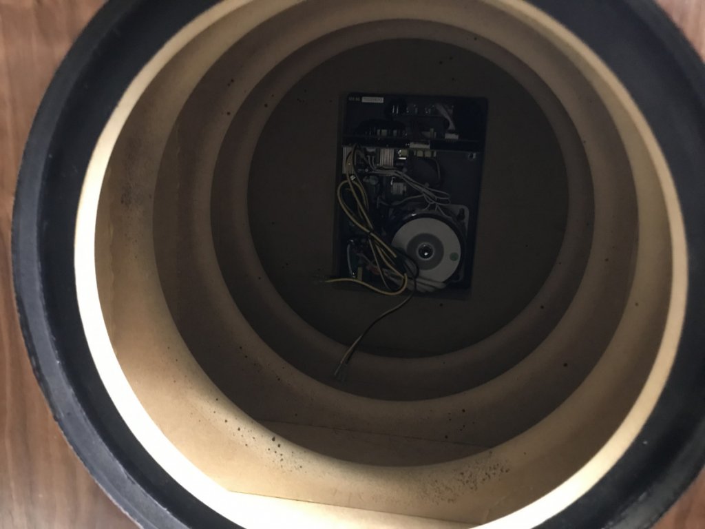

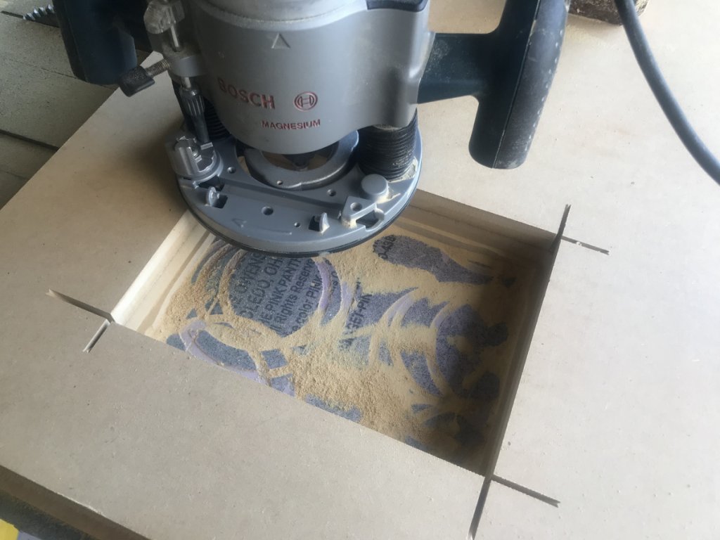

I built from scratch following the plans from GR Research. I did deviate by using 1” mdf, except front baffle, and made the depth a slight bit deeper keeping the same spacing between bracing. I cut out a plywood template using my tablesaw to use with a bearing guided router bit to cut out a clean hole for the amp. The majority of the waste was removed with a jigsaw.
Beautiful. Thanks for the extra pictures! Do you think I'd lose too much internal space if I just cut out a hole for the plate amp on the flatpack?

I assume you should be ok. Not sure how you’d mount the amp otherwise.

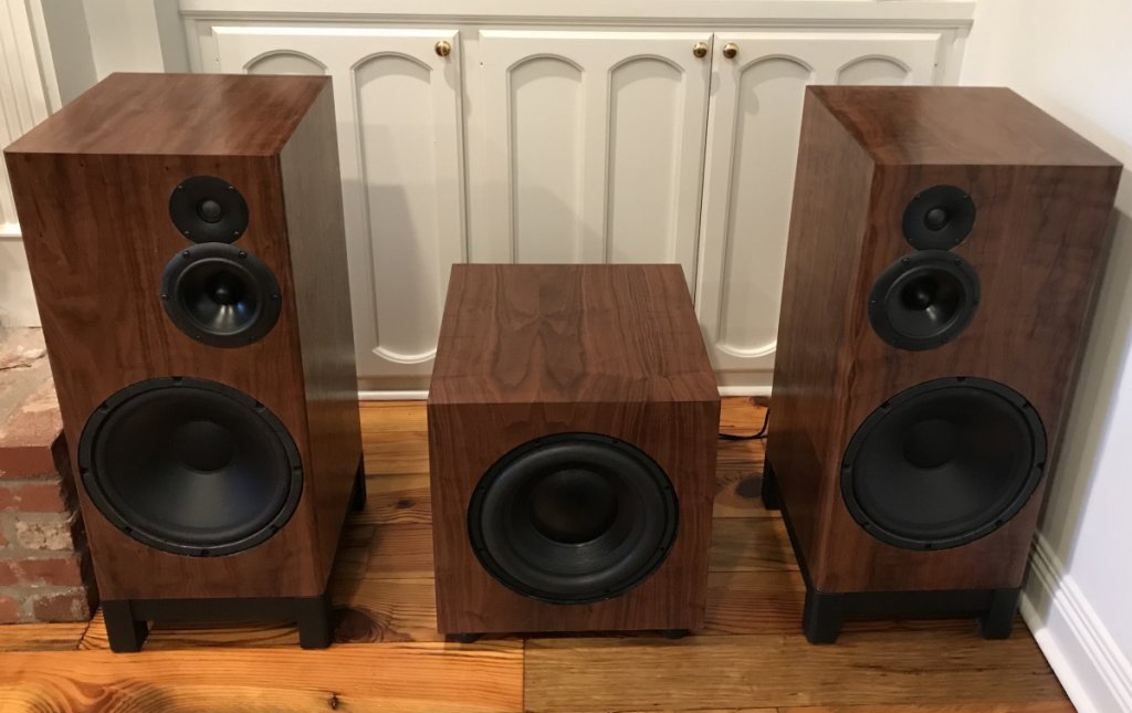

I finished the sub. The combo sounds great.

Stunning! Awesome work!

Looks fantastic. Really nicely done.

I really like how refined the finish is as a nice contrast to how stout and muscular they look.
