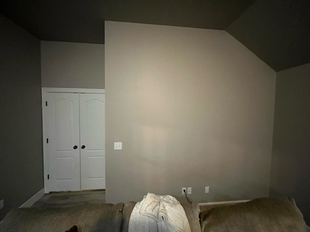

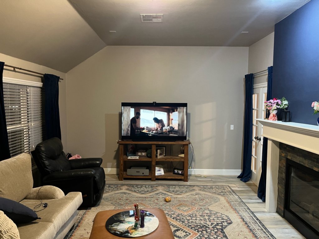

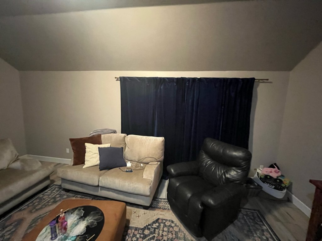

Here are the pictures of my listening room.  The room is about 15x22.  The recliner will be taken out when I get my speakers complete.  My NX-otica's  will be on each side of the TV stand about 3 to 4 feet out. I have that slanted ceiling on one side not sure what that will do to the sound. I have about 3.5 ft of empty space between the back wall and couch.
Front of the room.
Not exactly sure what I need to put on this wall.
Left side of room
Right side of room. I am going to put some sound absorbing art above the fireplace and maybe above the curtains.  There are double doors behind each set of curtains.
I am wanting something to put on the back wall to disperse.  Maybe a large book shelf.
Although this room is not perfect I feel like I have a really good area to work with.

Yeah, that room is going to need a little help. That front wall needs to have some tube traps in the corners, and a combination of absorption and diffusion will really go a long way to reproducing great sound.
