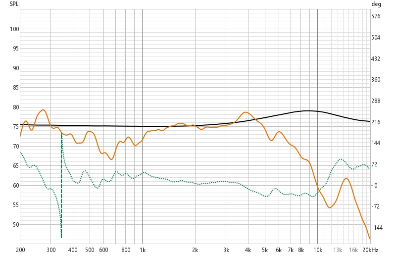

« Reply #23 on: 21 Apr 2024, 03:15 pm »
Here are my initial gated measurements. I am using REW and have the gate at .002 seconds. The mic is 1 meter away. This is my first time taking speaker measurements so I am wide open to suggestions and pointers.
This is just the two NQ midrange drivers.

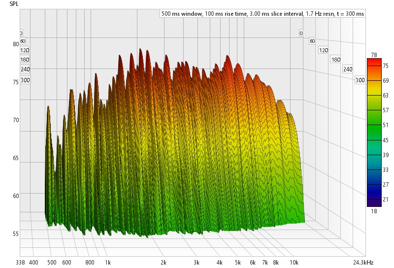

« Reply #24 on: 21 Apr 2024, 03:15 pm »
Waterfall for the NQ midrange drivers:

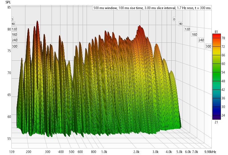

« Reply #26 on: 21 Apr 2024, 03:17 pm »
And here is the tweeter's waterfall response:

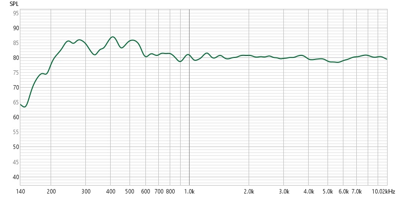

« Reply #27 on: 21 Apr 2024, 09:05 pm »
Here is the tweeter and the midrange response together. They seem to be pretty evenly matched in output. I am thinking 1800Hz would be a good crossover point for these. Does anyone else have input on the crossover point for the tweeter and midrange?

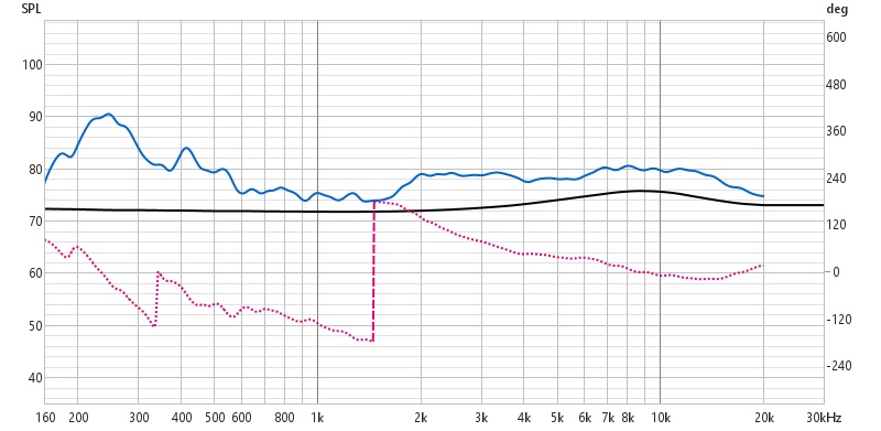

Thank you Danny. I thought about the distance difference with the woofers and the mids, but kept telling myself the wave lengths are so long below 200hz it shouldn't be an issue. Adding a plate amp would be a punt of last resort for me. I'd like to see if I can make it work without that if at all possible. Another idea might be to add the same rounded bezel for each of the woofers. If I did this, would you keep all the drivers at the same distance or would it be better to extend the woofers out 6" like you mentioned?
Right now I am using the same crossover on the tweeter as the X-Statics and I think the tweeter's response looks good. The midrange I had to play with a good bit. I kept moving the inductor and capacitor values up to get rid of a hump at 3.5K and a dip at 5.5k. I have 4mH coil and a 30uF cap on the mids in the measurement below. The tweeter by itself was smooth but when I added the midrange I got the peek and dip. Lowering the crossover point on the mid helped tame these.
The issue I have at this point is a huge hump at about 240hz. I don't really know what is causing that. Thoughts? This is just the mids and tweeter with no woofers yet.

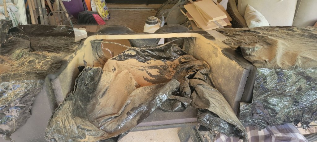

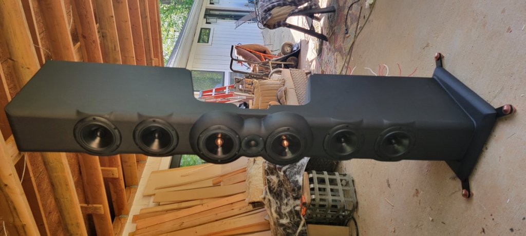

« Reply #36 on: 28 Apr 2024, 03:52 pm »

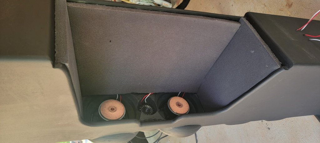

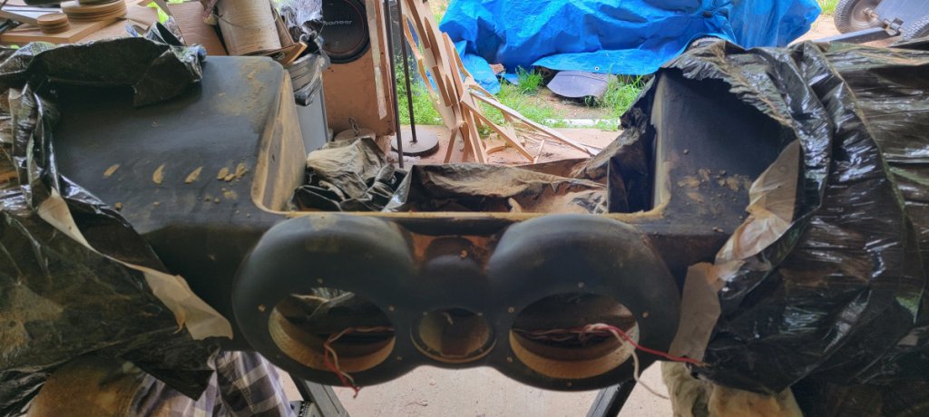

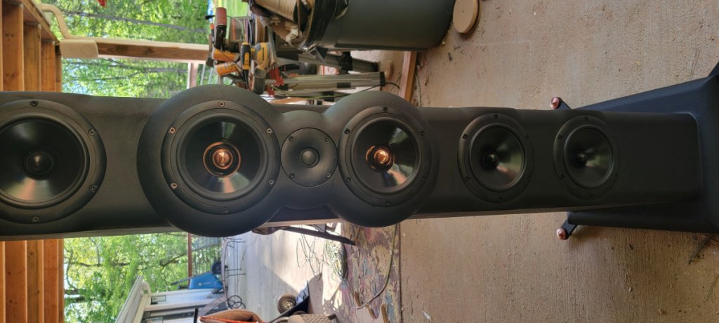

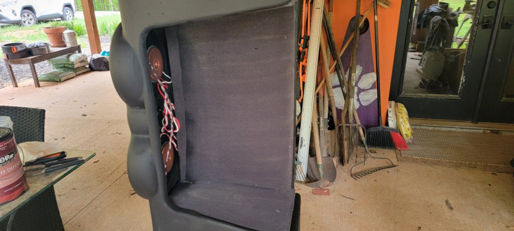

So I figured out what was causing the huge peak at 240Hz. I watched Danny's video on Open Baffle Basics 3 over and over yesterday and looked at his various measurements with the different length wings and decided my short wing was way too long and that was what was causing the peak. My short wing was 3.5" long but because of the thick front baffle I have on my speaker it actually added another 1.5" to the length of the wing for a total of 5".
I really did not want to take the finished speaker back out to my work area and start cutting and routering things again with the mess and the dust it would generate, but... I did. Below is the pictures of the carnage in modifying the short wing. I cut the wing down to 1/2", rounded it with the router and sanded everything before repainting the speaker. The wing is now 1/2" + the 1.5" deep bezel = 2 inches deep.

« Reply #37 on: 28 Apr 2024, 04:02 pm »
I took measurements again once I had the drivers installed again. I ran the measures just on the midrange and the 240Hz peak was gone! I played with the midrange crossover some more and went back to a 3mH coil and 15uF cap for the lowpass. There is still some waviness at the bottom end of the midrange's response, but overall much improved from what I had before with the longer wing. The measurement below is the midrange and tweeter together. I am very happy with the tweeter's response. The response of both sets of drivers together are super flat from 600Hz up. I am very happy with that! I have some ideas on how to flatten the bottom end of the midrange a little and still working on the high-pass for the midrange and the crossover for the woofers. See below where I am so far with the response:
