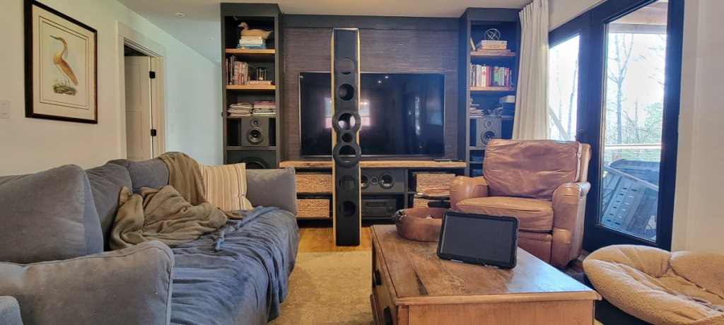

So, it’s been a journey. I discovered Danny and Gr-Research a few years ago and thanks to his tutelage via his YouTube videos, email exchanges and a phone call have brought be up to a whole new level of understanding in speaker design and audio reproduction. I have been studying audio since high school in the 80’s and the learning never stops. Thank you, Danny, for sharing your knowledge.
I’ve built several of Danny’s designs such as the X-LS Encores and the Encore Center speakers. I’ve used the flat packs and took some liberty on the Encore designs for a custom project as well.
I am a hobbyist and like branching out and experimenting with audio, so I have decided to take some liberties with Danny’s X-Statik design. First, I want to double the amount of low frequency drivers so that there will be two of the M-165-16’s in a sealed enclosure at the bottom of the speaker and two more above the MTM drivers in a sealed enclosure also. For stability, the sides of each speaker will be very similar to the NX-Tremes in that the inside side of the speaker will be a solid piece of MDF and the outside side of the speaker will be open for the MTM section of the speaker but sealed for the low frequency drivers. I hope this all makes sense.
Next, I will replace the M-165-16 drivers in the MTM section with the M165NQ/16 drivers. The tweeter will remain the T26SG driver. I will measure the responses and build a new crossover for the speaker. The speaker should be around 80 inches tall in total. My hopes are to increase the overall sensitivity of the speaker and I am hoping to lose the resisters on the tweeter. I feel like the MTM section and the low frequency sections will be very closely matched in sensitivity and doubling up on the woofers will help compensate for baffle step loss.
I am calling this new speaker the X-TC. I am open to anyone’s constructive criticism, feedback or suggestions.

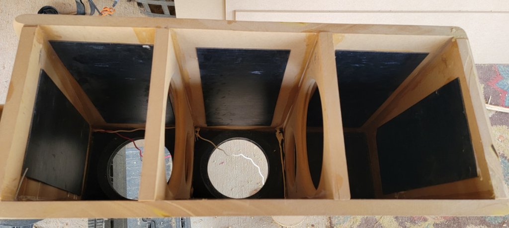

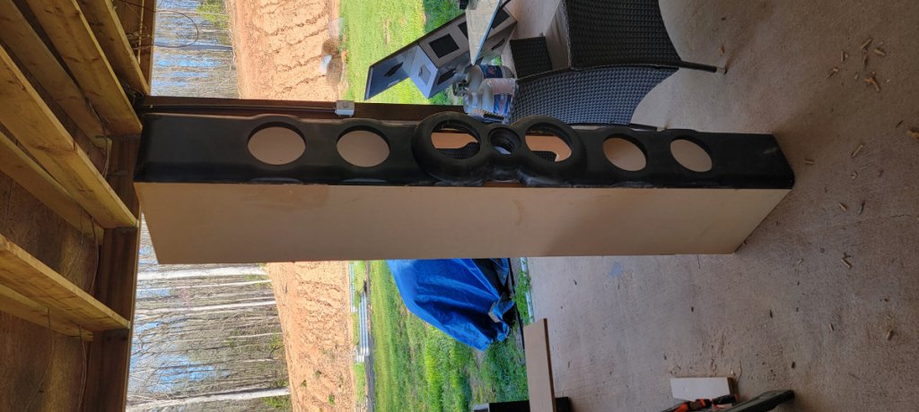

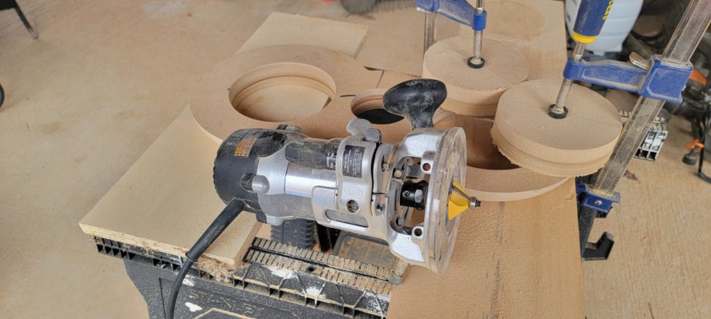

I turned a major corner today on my custom speaker project. I finished the 3 speaker pods that will house the midrange-tweeter-midrange (MTM) speakers in a "D'appolito" configuration. My hope is the rounded edges of the pods will minimize and randomize sound wave diffraction from the front of the speaker baffle. They have the side benefit of looking cool too. The drivers' outside edge will end where the rounded
taper begins.
It only took me about a dozen attempts and a few sheets of MDF to get this right. I am not a woodworker and I do not have the best equipment, the workshop or experience to get this project right. But I have the will to power through it all in order to build an awesome set of speakers.
These 3 pods are for the front left-center-right (LCR) speakers for me and my wife's custom home theater build coming soon.
The MTM pod build includes two 3/4" pieces of MDF glued together and a 1.5 inch rounded router bit used to round off the baffle edges.  The router bit I am using is huge at 3" wide and will chew through a board in a heartbeat so it took a whole lotta patience to get these pods done correctly.  To be continued...

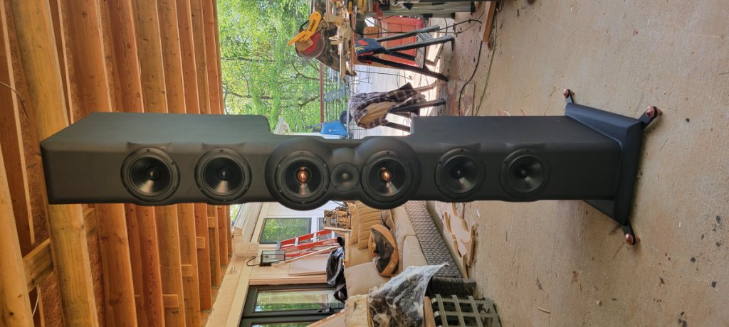

Made some more progress on the X-TC speaker project this weekend. All the work so far has been on the front baffle. Soon to follow are the speaker sides and supports and the speaker as a whole coming together. Stay tuned...

My best friend keeps calling them boobies as well. Okay, maybe I have some affinity for sexy curves...
I just spray painted these with flat black primer so I could see any blemishes or things I need to fill with wood filler and/or sand with sandpaper. The final finish will be some sort of flat back as these LCRs will be going behind an acoustically transparent screen and I need them to disappear both sonically and visually.

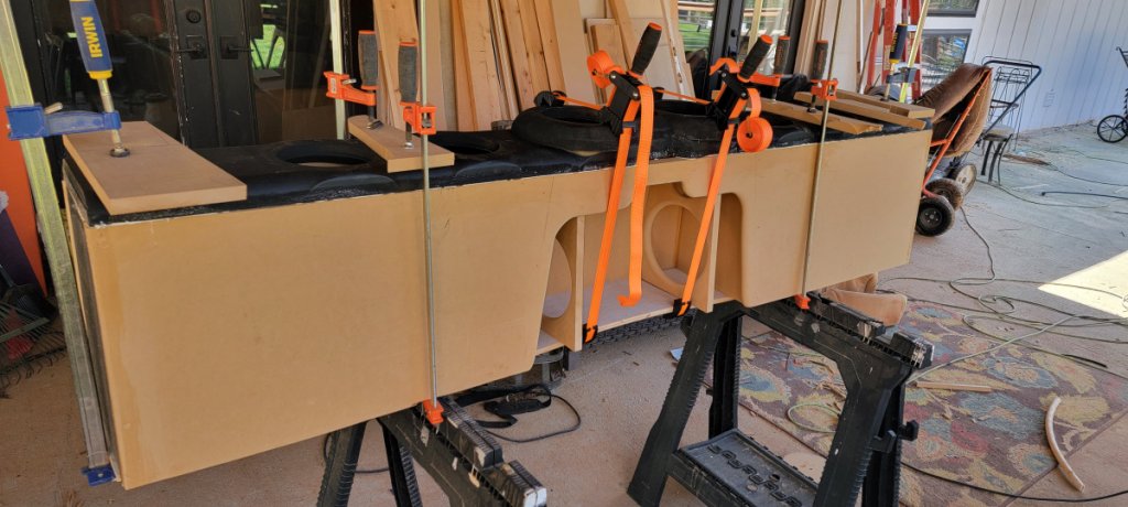

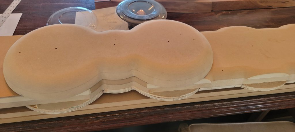

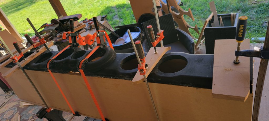

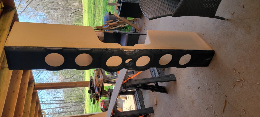

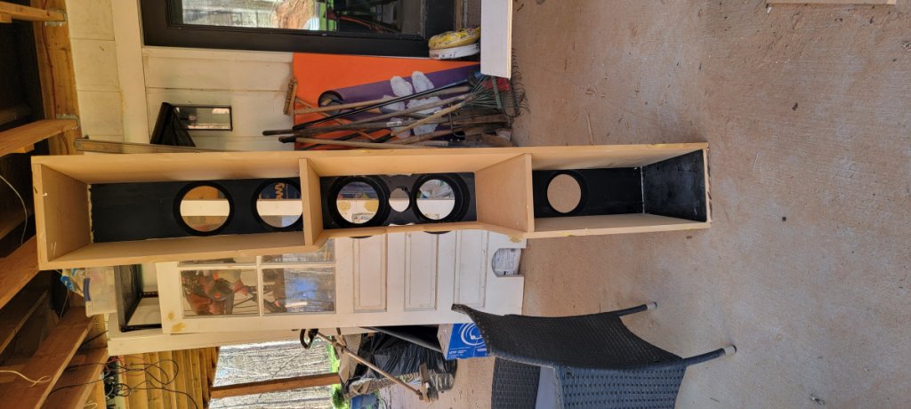

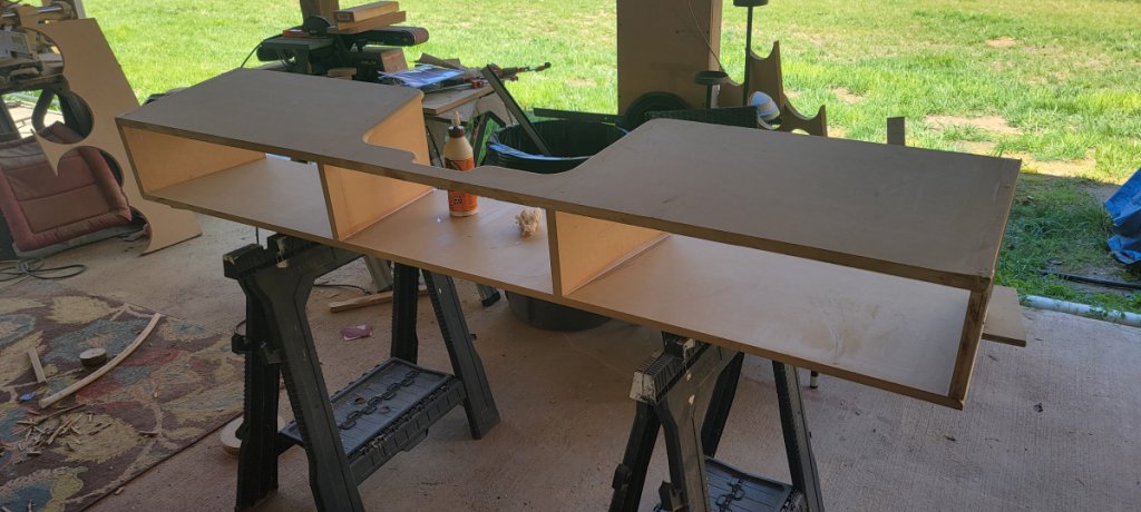

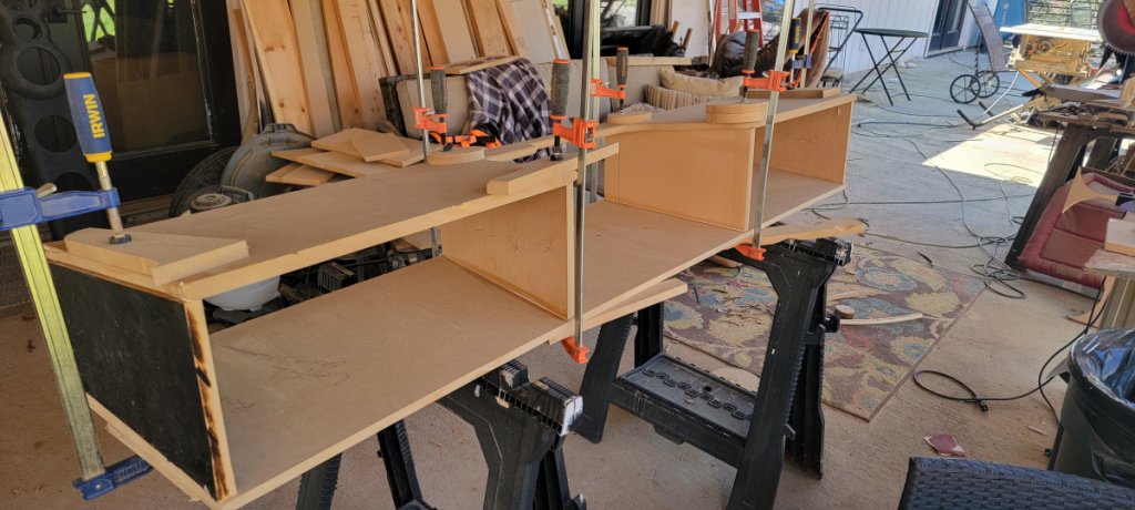

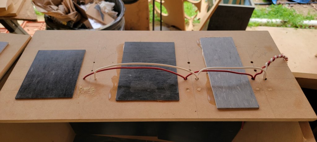

More progress on the new speakers. I had some PTO I needed to take or lose it so guess what I did all during my long weekend other than fish?
I am very happy with how the speakers are coming together. I am literally making up various parts of the design as I go. New ideas pop up as I make progress. I have a notebook where I write my ideas down and draw pictures. I also plan out the steps for each day I am working on the speaker and write them down so I can think through the process. Here are the latest pictures...
JustPlainNuts
  • Posts: 31
Re: Modifying the X-Statik to become the X-TC
« Reply #17 on: 4 Apr 2024, 09:01 pm »
Somehow the order of my pictures got all out of whack, but I think one can see the progression once they have seen all the pictures.
