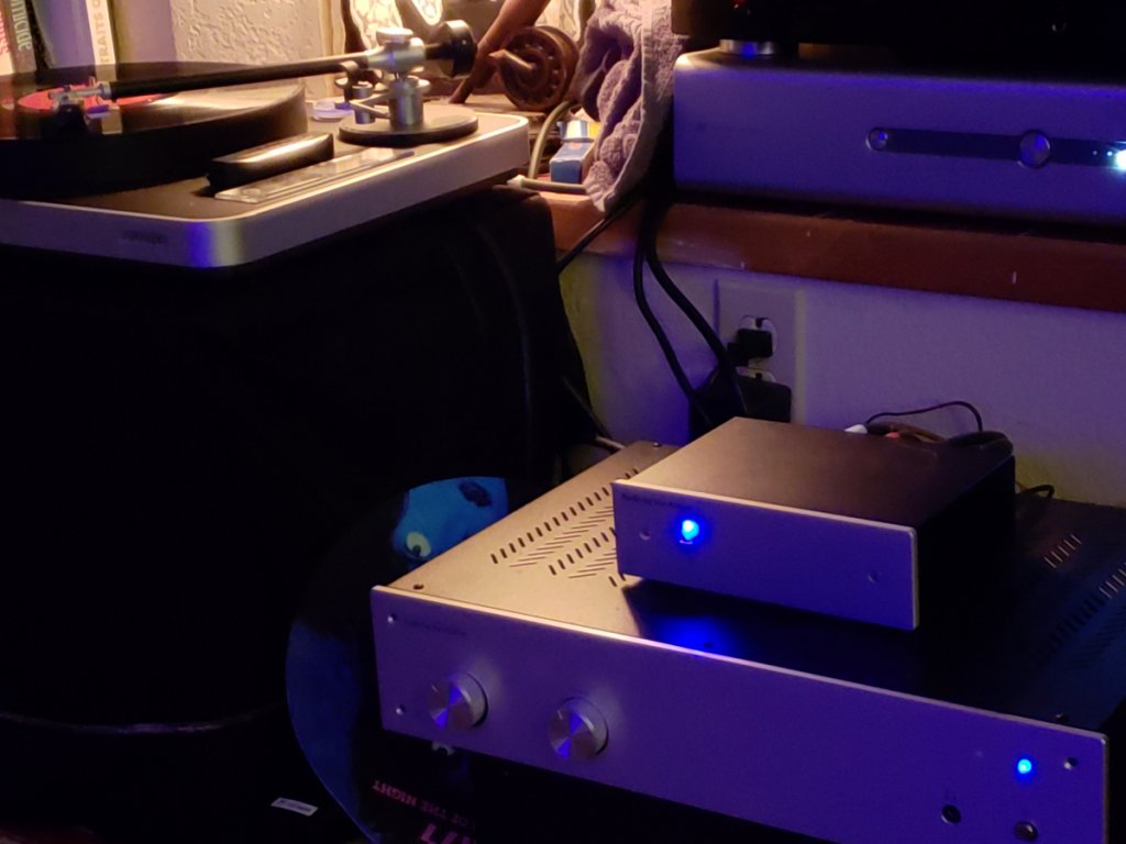

A joyous combination of gear... AVA Set 120 Control Amplifier with the Vision Q+ Phono Preamp... scintillating...
