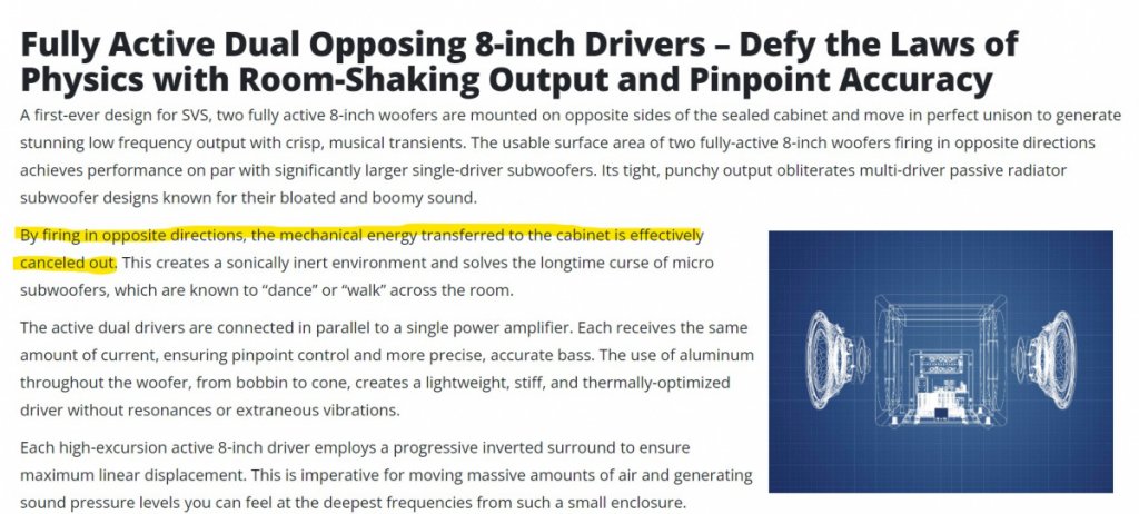

With a Maggie, the back wave is 180 degrees out of phase.  I'm not positive about this, but I doubt the SVS sub works like that.
I'm pretty sure that's how the SVS works, when one side is moving out, the other side is moving in, 180 degrees out of phase.
The cabinet is never pressurized because of this, making it effectively "open baffle" because there's no cabinet effect.
I've attached a picture from the SVS page which seems to indicate this is the case.

The SVS drivers are in phase, they move out and in together otherwise there would be cancellation and the two 8 inch drivers wouldn't perform like an 11 inch driver.
The highlighted section references mechanical energy transferred to the cabinet by movement of the drivers, both of the drivers push on the cabinet and pull on the cabinet.

As opnly bafld indicated, The SVS drivers do not behave as you described.  It is a “bipole” design, whereas the OB sub is a “dipole” design.  As indicated in the SVS document you referenced, the bipole design keeps the cabinet from moving back and forth (there certainly IS pressure being created inside the cabinet).

That's the info I was hoping to get, it appears I am not getting the benefits of dipole with this. Thanks guys.
