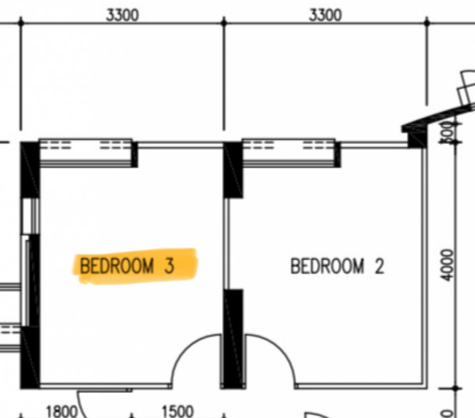

Hi everyone and happy new year!
Most of the material I see about OB speakers show large listening rooms. Does anyone have recommendations for what OB speakers would be suitable for a room (bedroom 3 in image below) that is 4m by 3m by 2.7m (L x W x H - 13ft x 9.8ft x 8.8ft)?
I know OB speakers need to be 3 feet away from the front wall, but can they be placed close to side walls?
Thank you for any guidance!
Timothy

As an owner of a house with a small 3rd bedroom (10lx12w) and also a set of NX-Studios, you aren't giving up anything with that speaker setup. Very favorable near the front wall or pulled out into the room. Small rooms like that will really boost the bass response to where subs will be recommended but almost optional depending on the genre. Treat the room heavily, keep the speakers on stands about 24" tall, and keep your seating off the back wall and you'll be about as good as can be given the space constraints. Pair with a single or pair of small sealed subs and you'll be a happy camper.

Thank you all for the recommendations! I was hoping to at least squeeze in the NX-Oticas if I go with the NX series but will keep my mind open and read up about the NX-Studios :)
