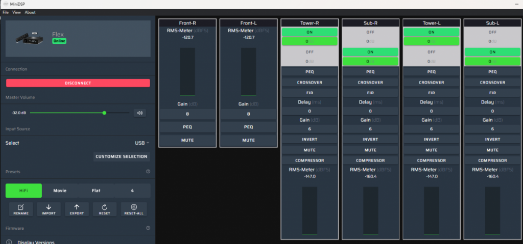

I have over the last year purchased, and built speakers from GRResearch.  Built a Dynaco ST120 Tube Amp.  Treated room, purchase UMik-1 calibrated mic.  And tried to do final "room tuning" via various YouTube Videos.   Then upload correction file to my MiniDSP Flex.
But I think the peice of that process that I am least confident in my doing correctly is the process to room correct, know what I am looking at and deciding if its "good" or ok... or.. well.. need more investment.   To make any more investment, I first need to walk through sufficient review of what I have to create a more "critical" baseline.   Not just "it sounds good to me" but also, what do measurements show.

Ex: Two attached images.  I think I have correctly collected data but it is not in same format I see Danny review speakers.. so I can't tell if this is "good"... or.. something is BAD.
This is average scans: Head Center, then +/- 6" each direction
This is waterfall view.  But I don't think I have some setting of scale set correct to be able to know if this is good or bad.

The scans look great but the broad dip around 40 Hz can't/shouldn't be corrected with DSP, that's what a subwoofer is for.
