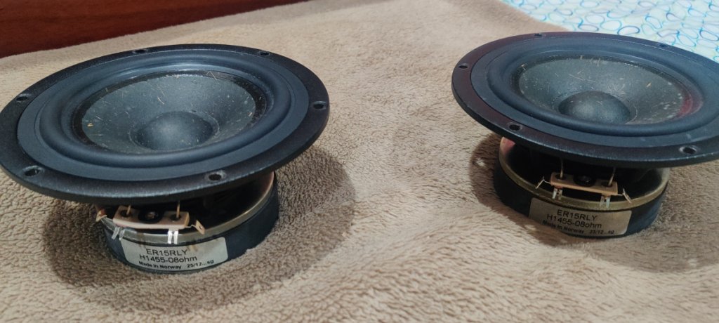

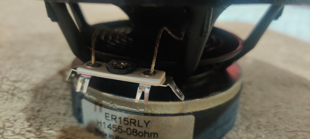

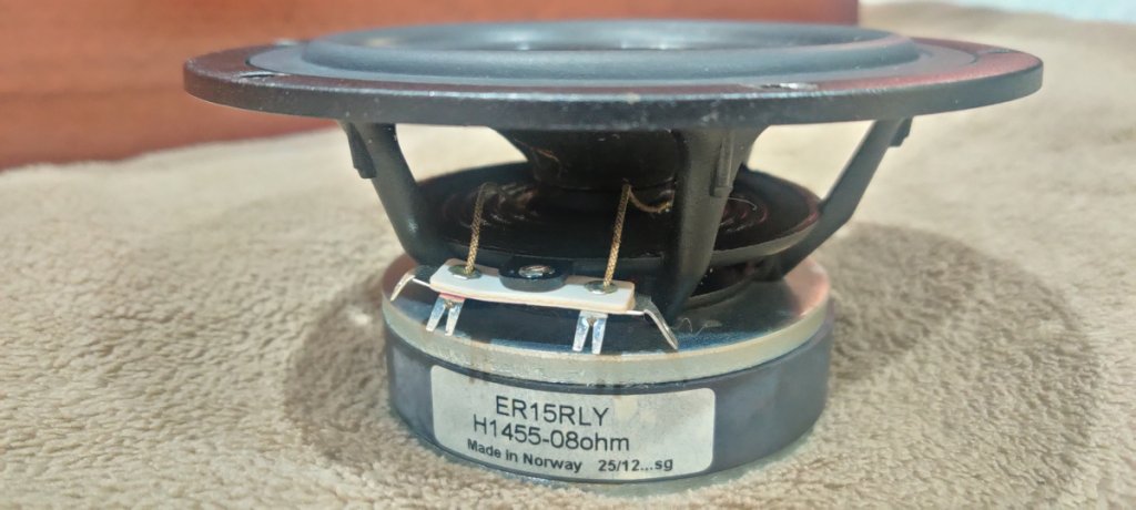

I opened the drivers, I don't see any obvious signs. I checked the continuity and resistance with the basic MM I had. Both drivers show 6.x ohms and looks okay to me.
blackscorpio
  • Posts: 33
Re: Songtower RT one speaker sounds low/odd

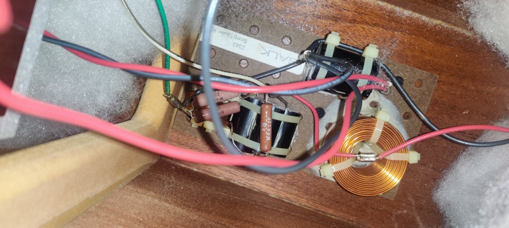

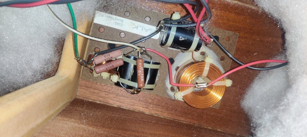

« Reply #7 on: 1 Aug 2024, 02:56 pm »
Just took pictures of the inside also in case it helps.
Nothing looked suspicious to me.
