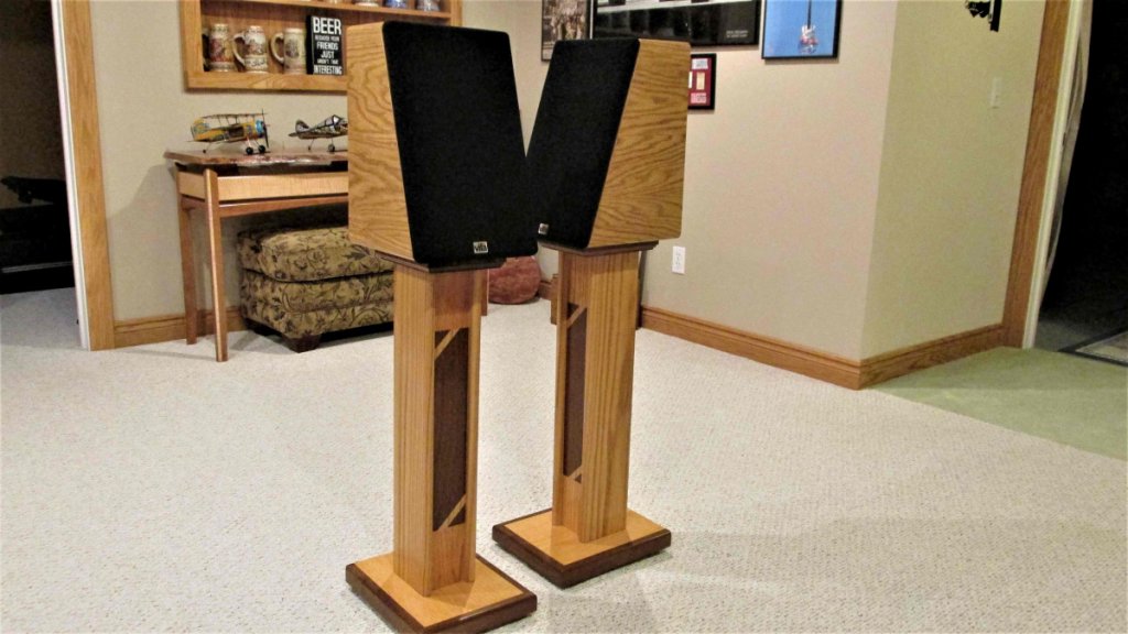

An off topic reply. My first set of DIY speakers a set of ACI SR2's. I loved those speakers. Best speakers I ever built, until the next set. :lol:  No seriously they were very nice sounding.
Thanks for the memories.
