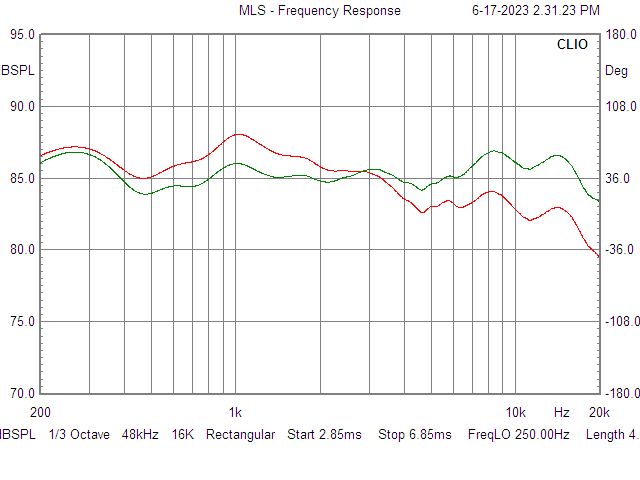

Original Measurements
Overlay - Original Measurement / Tweeter Polarity Corrected / Tweeter Polarity Corrected & Notch Filter Added
