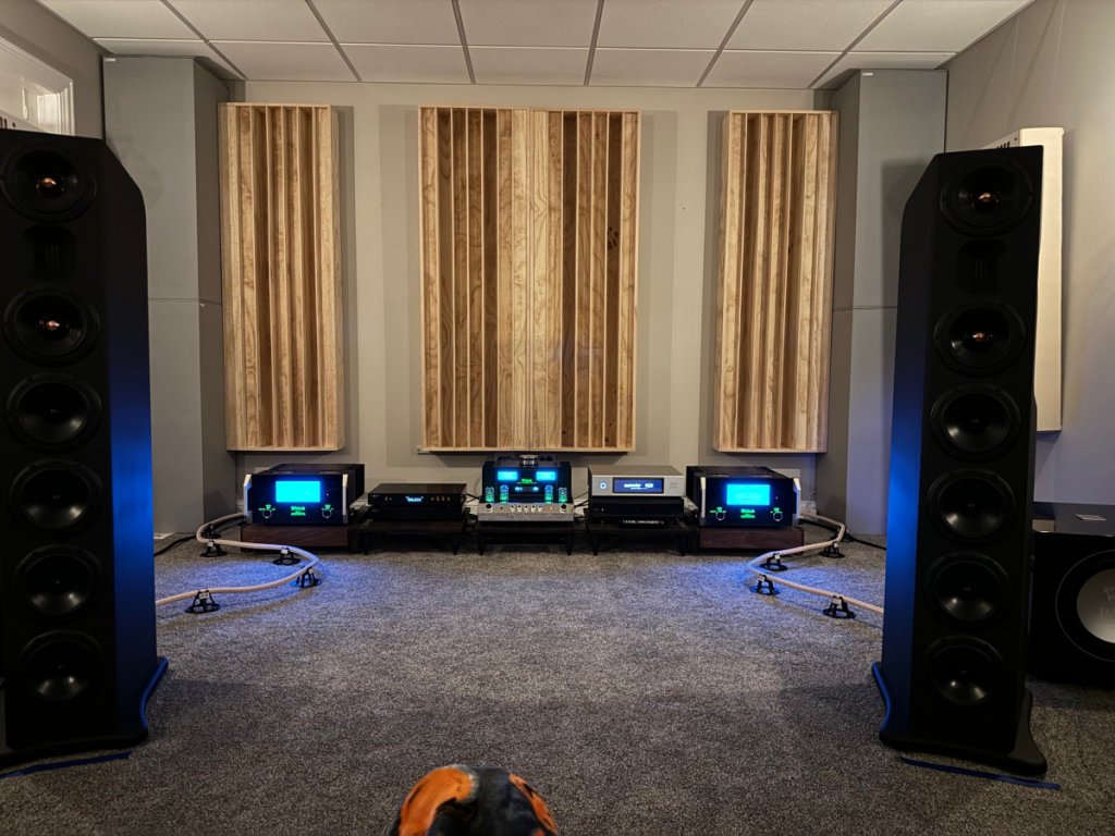

I’m using Isoacoustics GAIA iii on my Monitor Audio GR20s (4) and on my KEF LS50 W2 /S2 stands (2). Two separate systems.  Each is platformed with three inch thick maple platforms from Butcher Block Acoustics.  Two platforms for the main system of two sets of GR20s and two for the Mancave KEFs.  The platforms have castered wheels so they can be easily positioned.
vonnie123
  • Posts: 364
Here’s the Monitor Audio GR20s   Sorry they posted sideways….
Floor surface in both rooms is porcelain tile on concrete slab.  The ability to adjust positioning is helpful.
