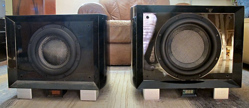

The G1 MkII is a beast at 22.5" wide, 26.8" deep and 18.2" high and weighing in at 108 lbs. The sub has a single 12" long throw (2" forward and back) carbon fiber cone in a curved sealed box powered by a 600 watt ultra high-current class A/B amp. The manual says:

For home theater, the G1 MkII wins hands down. The sub has the same clarity as the G2 but moves a lot more air effortlessly, it's the combination of a larger A/B amp and a 12" driver with a longer 2" stroke. For music it's a bit of a toss up. The G1 MkII is still breaking in but I feel the G2 is a tad quicker. The G2 has to work a little harder to move the same amount of air, it sounds a little punchier, the effect is addicting. The G1 MkII is more natural with lows effortlessly spreading throughout the room with definitely more space around the performers on naturally recorded music, -6 dB at 15 Hz will do that.

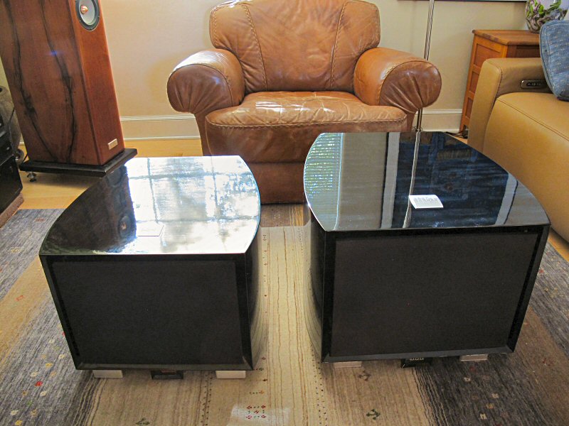

I still have the REL G2 in the house, a couple friends would like to borrow it. Eventually I will sell it because I don't have room, my house is only 750 sq ft. REL always recommends using two subs. I then had an epiphany: "Hey, I got two subs, what the hell am I waiting for?"
Music is interesting but the 2nd sub location is not ideal. Maybe I can hear an even larger recorded space but the added bass is a little too much of a good thing. But for movies, OMG!

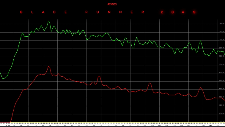

I have this test album: Blade Runner 2049, Denis Villeneuve's masterpiece with music by Hans Zimmer. Sound demos usually include explosions, submarine depth charges, Godzilla stomping and roaring but nothing has sustained 15 Hz - 30 Hz bass that goes on for 15 seconds or more like this soundtrack album has. Track 1 - '2049' and track 3 - 'Flight to LAPD' will tax any home theater. Playing both tracks at theater levels scares me, I eventually have to turn it down. Everything in the house vibrates including my body. Eyeballs are filled with fluid, when that fluid starts vibrating and my vision starts getting blurry it's time to turn down the volume, yet another successful experiment. Don't try this at home kids.
