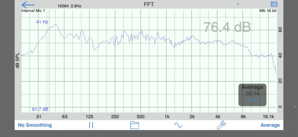

Nice, Qobuz is what I use, too.  That makes it easy.  Search for the album titled "Pink Noise" by the artist "White Noise Spectrum".  Here's what it looks like on Qobuz:
Measuring Process
1. Play the pink noise track through your stereo.
2. Open the AudioTools/Spectroid app and select the FFT option.  It should give you a live readout like this:
As you can see, I had a big hump at 50hz that I needed to deal with, which I was able to reduce using the PEQ function in the amps.
