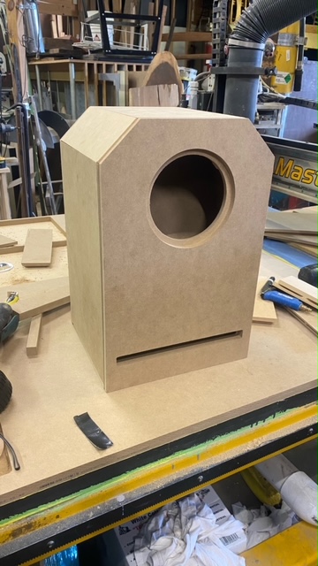

I'm having a flat pack made for the Lii F6-S and received some update pics this afternoon.

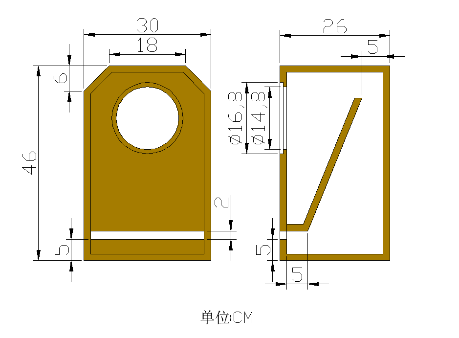

FullRangeMan: I do not know what the interior volume is, but here are the plans he provided. The plans are also on the website. He sells a finished version with the F-6 for $599 called the Emmo F6. All measurements are in cm. The guy I took it to did not notice that the measurements were metric. I had to tell him to look at the legend after he told me it was going to be 5 sheets of mdf.  :lol:

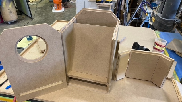

« Reply #7 on: 29 Sep 2023, 03:53 pm »

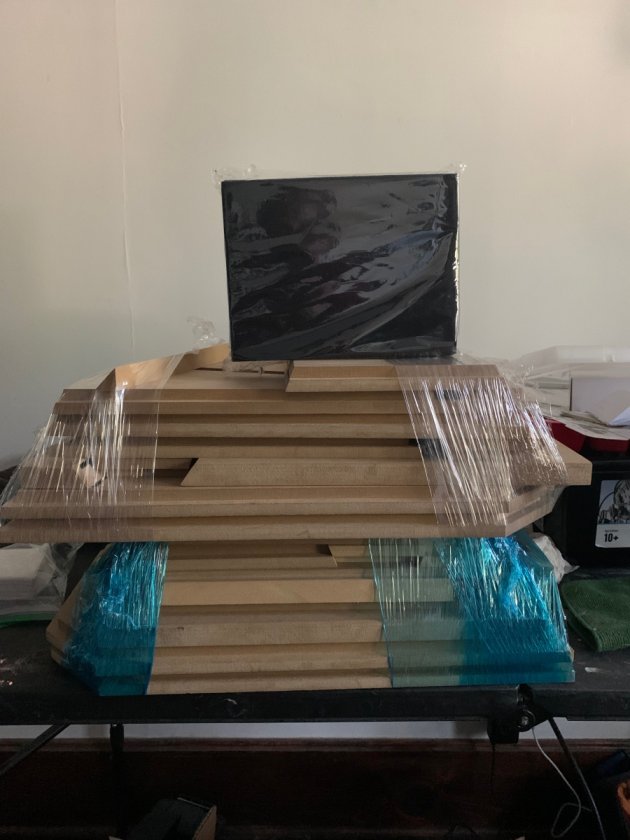

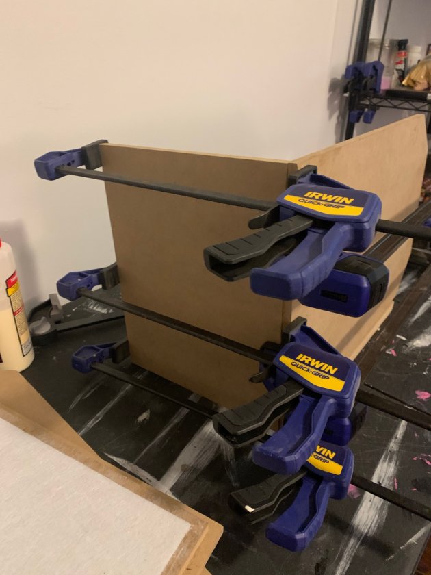

I picked up the flat pack for the pair of enclosures for my Lii F6-S drivers. The black material is felt to apply to the inner walls to help reduce the interior reflections inside the box.

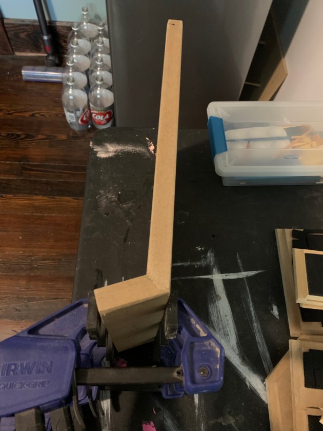

« Reply #9 on: 29 Sep 2023, 11:26 pm »

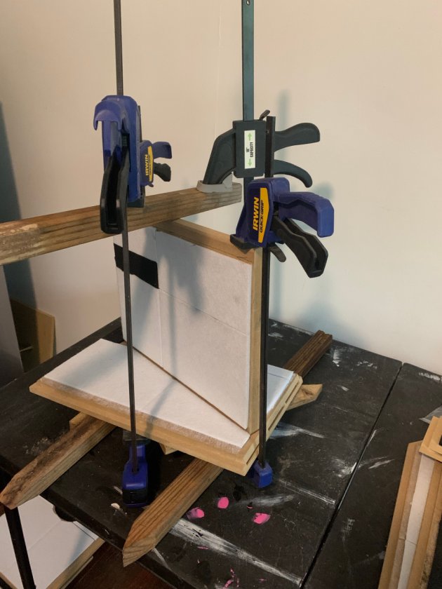

I glued up one of the interior braces, ensuring that it would go into both sides of the enclosure without a fight.

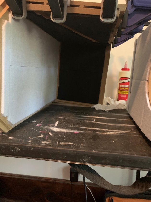

« Reply #14 on: 3 Oct 2023, 10:14 pm »

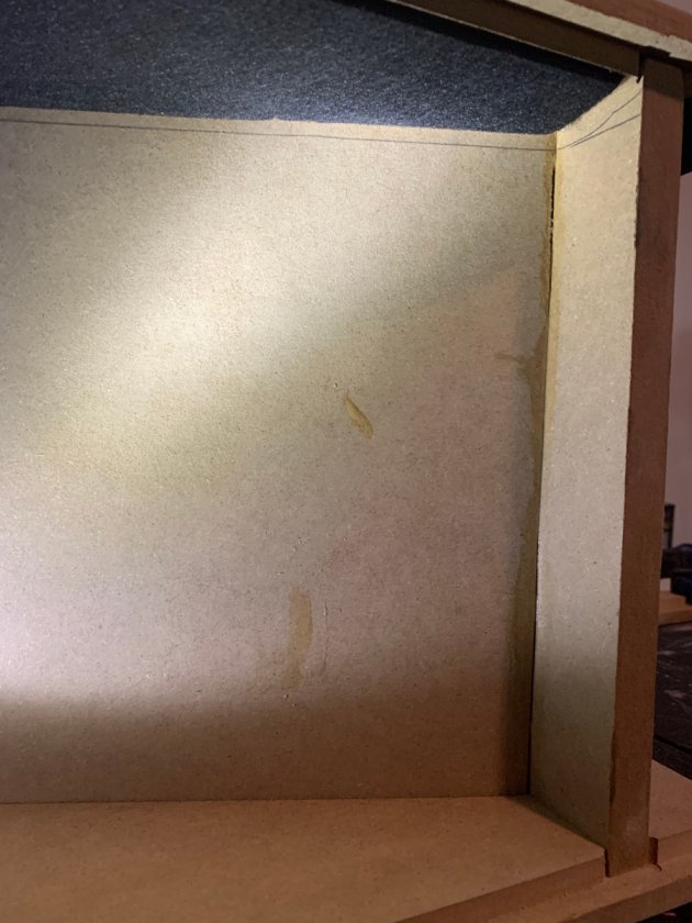

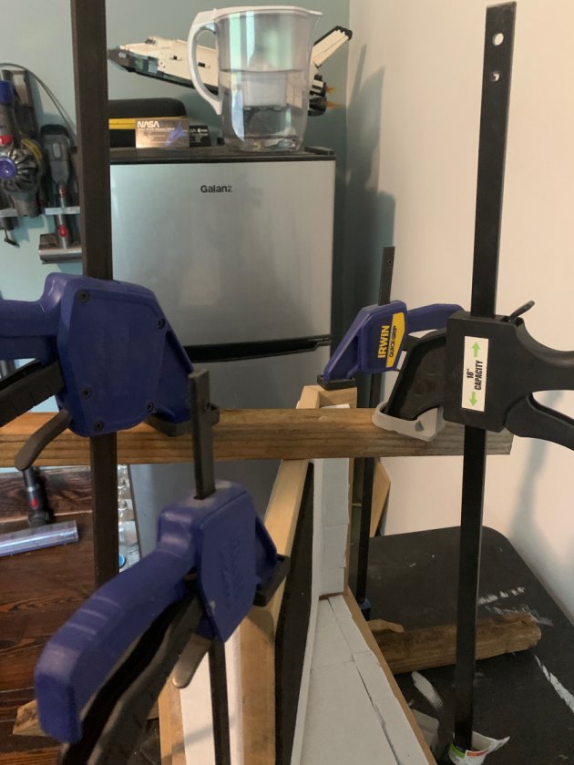

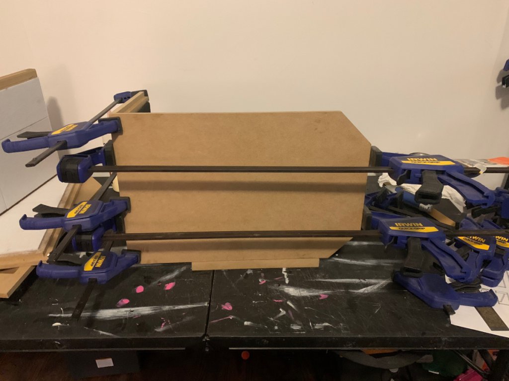

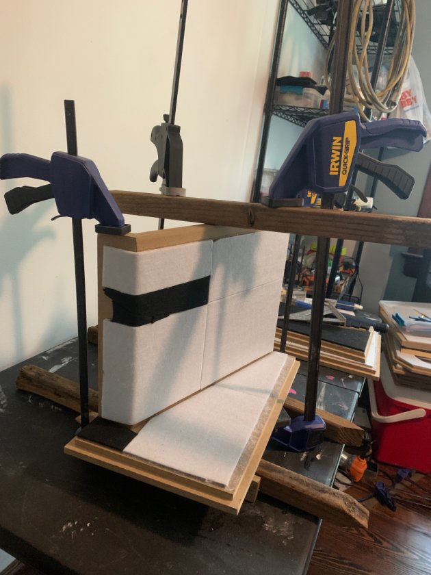

I finished lining the inside of the boxes and it took me awhile to figure out how to glue it up. I started with the interior brace/baffle gluing it in place on one side, making sure I had 90 degrees on both sides of the brace while clamping and after. I guess we'll see if it worked or not.

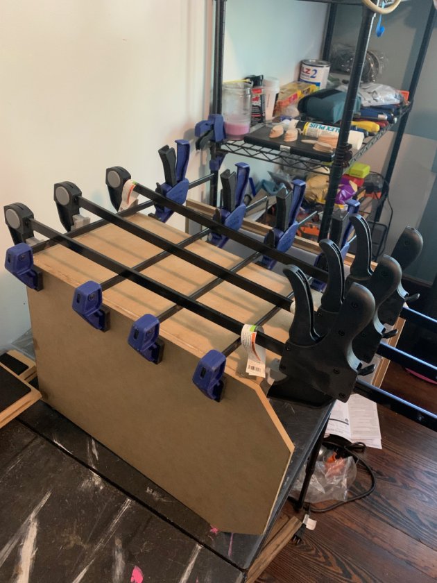

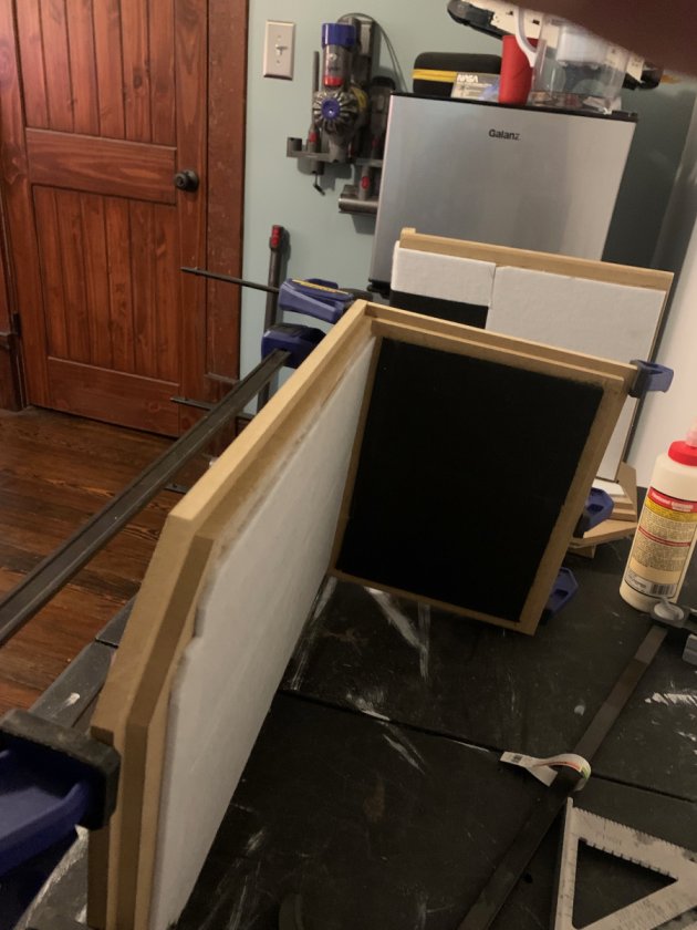

More unwanted updates on me project. First box assembly is progressing slower then I want, but there is progress.

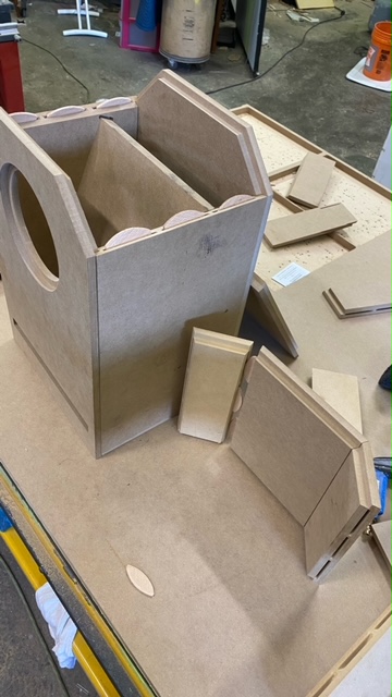

And Thank You seikosha, very kind of you as well. I certainly feel good about you and Letiroll's comments. Thanks guys. I figured out I need a few more 24" clamps to properly do the job, which means I get to go Harbor Freight to grab a few more and to see what other trouble I can get into.
