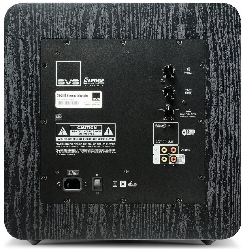

I'm trying to incorporate a a tube preamp, namely a Rogue RP-1, into a HT headed up by a Marantz SR7012 so that I can isolate the AVR when playing music. A Bryston 4B powers the fronts. I can use the HT bypass easy enough but how best to incorporate the subwoofer, an SVS SB2000?

Ideally the sub would be connected to BOTH the Bryston AND the Marantz at the same time. Many subs have two inputs: a high level (speaker) and low level LFE (Low Frequency Effects) inputs. These two inputs are designed to be used at the same time. Unfortunate your sub is not designed for home theater and does not have 2 inputs. Replacing the sub would be the most elegant solution.

You cannot connect both the Marantz and the Rogue RP-1 into the subwoofer at the same time.
Connect the Marantz line-level outputs to the HT bypass input on your RP-1. Connect your RP-1 left and right outputs to the SB-2000 line-level inputs. Connect the SB-2000 line-level outputs to the Bryston 4B3. Use the SB-2000 crossover settings.

Time for some clarification and definitions:
Subwoofer High Level Input: This input is connected directly to the AMP/Speaker Wire, usually by a Neuteric plug. The SVS SB2000 DOES NOT have this connection.
What is a High Level and LFE Connection?
https://relsupport.zendesk.com/hc/en-us/articles/115004486987-What-is-a-High-Level-Connection-
Subwoofer Line Level Input
: The SVS SB2000 has two line level inputs. The Marantz has L&R line level outputs and the RP-1 has L&R line level outputs. Pick one or the other, the Marantz and Rogue RP-1 CANNOT be plugged into the SVS SB2000 sub at the same time.
This will work, sorta kinda. I don't know how transparent the SB-2000 Low-Pass Filter is, it would be a shame to insert a crossover between the excellent Rogue and Bryston, but if you must, you must. The Low-Pass Filter in the SVS SB-2000 will send lows to the sub and filtered mids and highs to the Bryston amp. The filter can be adjusted but I didn't read where it can be set as a pass-thru for the main L&R speakers.

Marantz front preout -> Rogue via HT Input -> #1 output to Bryston, #2 output to subwoofer. That would be easiest way to keep music isolated and HT setup clean and tidy. If you need to get an rca-xlr adapter then no problem there. Lots of options available. You wouldn't get the room correction with the subs, but just run your speakers full range and adjust the dials on the back of your sub to best setting. A little more manual labor, but it eliminates a lot of issue. If you still want more subs for HT, then plug one or two more into Marantz only and have the front speakers still set to full range.
