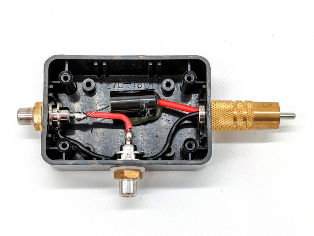

Put them between the amp and preamp, with a Y-splitter before the high-pass so one leg is kept full range for the subs
You can also build a full-range output (bottom) into the filter itself like this:
BGA
Re: Amplifier internal high pass filter
« Reply #6 on: 28 Aug 2023, 06:15 pm »
One thing to remember is when you add a capacitor there will be a phase shift so you may have to adjust your subs phase to have it blend properly with your mains. I tried a few different frequencies with my X-Otica's and Double Troubles and found they still sound best full range and just low pass the subs.
