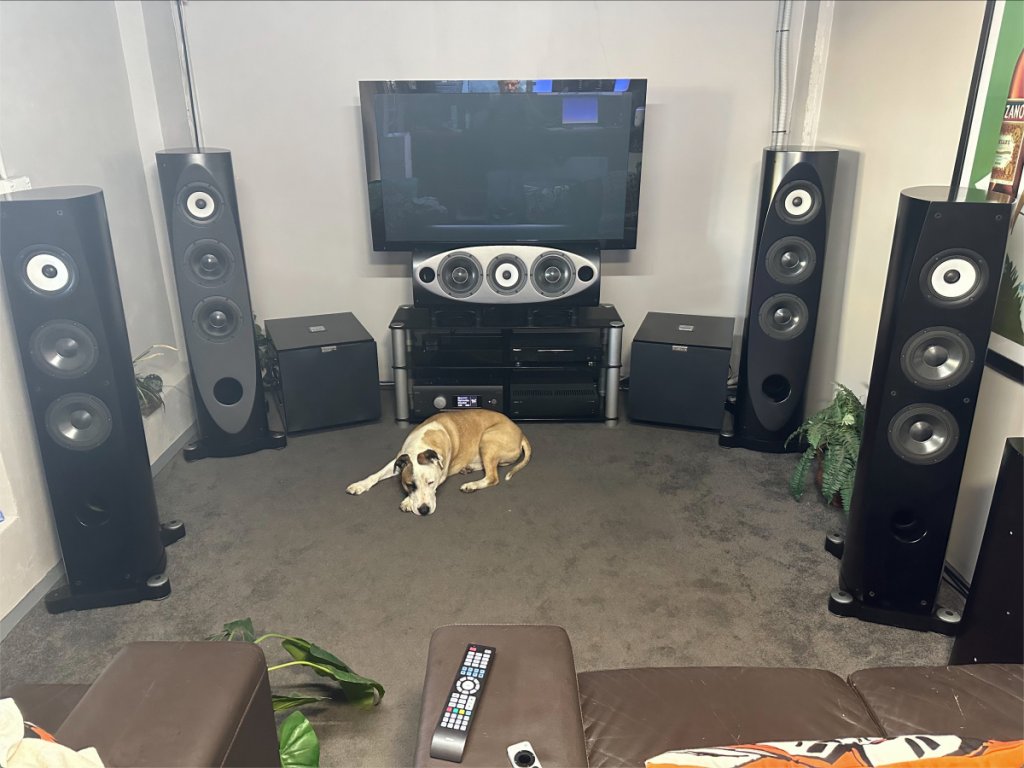

Im new to the forum, so wanted to say hi and introduce myself, im Lee, I live in Bundaberg, Australia... I moved from UK around 12 years ago and brought my Pioneer S-3EX and 8-EX TAD derived speakers with me, which I absolutely love... recently I've been upgrading and found some of the bigger Pinner S-1EX and S-7EX models in Japan for a price too good to pass up...
...anyway long story short, I had them imported and the floor standers are just to dei fro, but the center channel tweeter arrived not working... I bridged the Mid and Tweet terminals (at low volume) and the tweeter sprung to life, so its a dodgy HP filter by the look of it...
... just wondering should I take this opportunity to upgrade all 3 speaker crossovers or just replace the parts in the centre channel....obviously at 40Kg and 70Kg they are too heavy to send to Danny and the team at GR Research...
... so, just after advice on where people think is should go next, some pics attached... need to get the boards out and get a schematic together.
