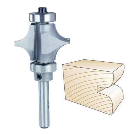

The Whiteside 3196 has a 1/4" shank, a 3/8" inverted roundover and at 1-3/8" diameter should scare the hell out of you when used in a one-handed palm router. Even with 40 years professional woodworking experience I wouldn't attempt it one handed, but then I still have all my fingers too.
Whiteside has smaller radius bits: 1/8", 3/16", 1/4"
https://www.whitesiderouterbits.com/products/3196
$64.25 at Amazon

So far the only rounding under bit I have found with a 1/4" shank is the strange looking one above. The other Whiteside rounding under bits are 1/2" shank. I might have missed some.
I would make an extra large custom base for your palm router so it will never fall in the speaker hole or accidentally tilt.

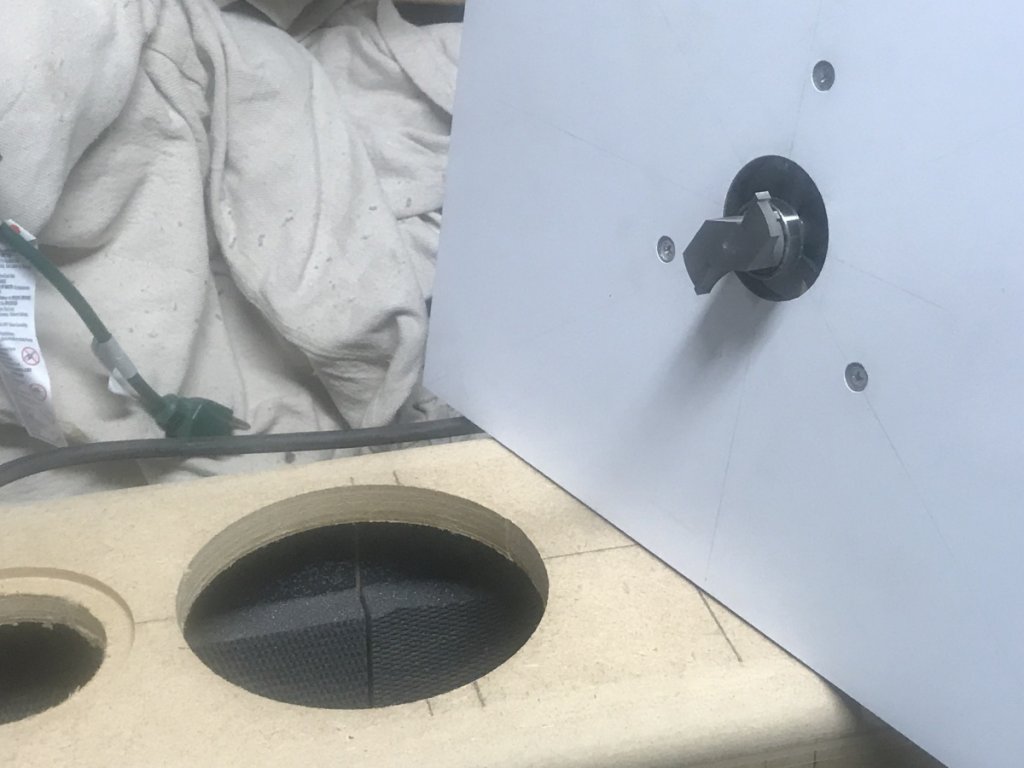

The rounding under bits I have, and have seen, are large and heavy. They have 1/2" shanks for a reason and need a full size hand router to be able to power and control them. A router base large enough to completely cover the cutout opening when the bit is engaged is also, at least from my point of view, necessary for both safety and to keep the router from tipping during the cut. I made mine large enough that no part of the opening is exposed at any point during the cut.

If you do find an appropriate radius round under bearing bit with ¼” shank (I couldn’t)
++1 oversized base plate is absolutely critical for safety’s sake.
And remember you do not have to make this entire cut in one shot.
A palm router may not have the horsepower to hog out all that wood at once.
Approach your final target depth in multiple passes . For the best finish  save the smallest change for the final pass.
Example: for a 3/4” round over bit, pass:1 = 1/4” shy  > pass:2 = 1/8” shy > pass:3 = right on the money.
It sounds like 3 times the work but you will be one with the machine by the third pass.
Or get creative with a medium/fine hand rasp, it won't look pretty but heck, it's on the inside  : )
The entire router bit does not have to be used. Whiteside 3196 (see above)

If a 3/8” round over is sufficient for a 6/8” baffle.
You have found the biggest radius 1/4" shank pick = Whiteside.
I was looking for 4/8" round under, they are all 1/2" shanks and rightly so.
