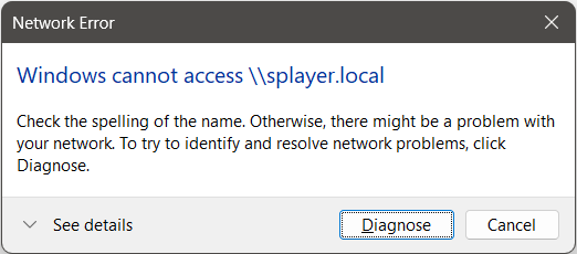

Something labelled R913V16T is now showing up in File Explorer after rebooting the Streamplayer. I am assuming it is the Streamplayer. It is asking for a usermame and password. I think the username is "splayer" but I don't know the password and it is not accepting a blank field.
Jim, I tried your suggestion and both times it said Windows could not access them. I can stiil access the Streamplayer through a browser to use for listening, as seen above, I just can't access its file system.

jsalk
Re: Salkstreamer II with Windows 11 network
« Reply #5 on: 2 Jun 2023, 05:29 pm »
R913V16T is not the StreamPlayer (it may be your router). You should not need a username/passowrd to access the StreamPlayer via the network.
