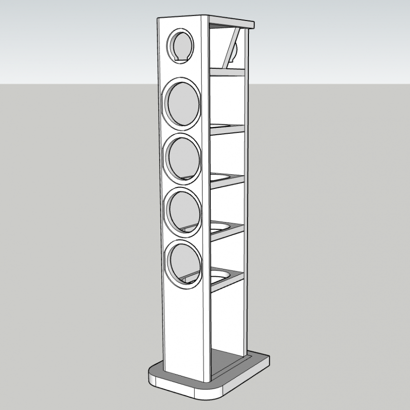

They may have an interesting sound, but I still don’t understand who will use floorstanding speakers in a small living room if their bottom end is 65 Hz. I mean, you can’t listen to any music with them without a sub or two. If you want to save space, you won’t (you have to find space for subs too). If you want to save money, you won’t (good subs will cost you more than these towers).

I agree with @zlib. It should have a well designed front, rear or side bass reflex + foam plug.
Later, if successful, a version with a transmission line.
https://gr-research.com/product/lgk-2-4-towers-pair/
Foam plug as the expensive ($6000) QAcoustics Concept 500, with two options.

If we made the 2.4s a ported speaker, the cabinet would need to be nearly 2x the current size, which makes the speaker more expensive and take up more space.

Sealed bass is going to act different than ported bass.  With ported bass you get a deeper bass but it's looser.  Also, with ported bass, your in-room response will drop off very quickly below the port tuning frequency.
Sealed bass is not like that.  It has a very slow, gradual roll off that will mate with the room gain and give you MUCH lower bass than the box tuning.  So, a sealed box of 65hz will (in my real-world experience) give you bass to 40hz for sure, and often a bit below that even.
maty

A rough estimate
LGK 2.4
Height: 41.5″
Width: 6.5″
Depth: 9.5″
-> 42 liters
LGK 2.4 sealed: 65 Hz
LGK 2.4 vented -> 54 Hz (-3 dB) :?
Correct me if I’m wrong.
Tyson really nailed it with his post.
It is easy to get room gains down low in a small room. So something with a sealed box and more gradual roll off really helps.
